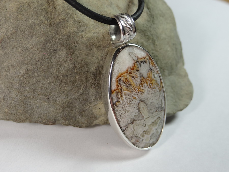

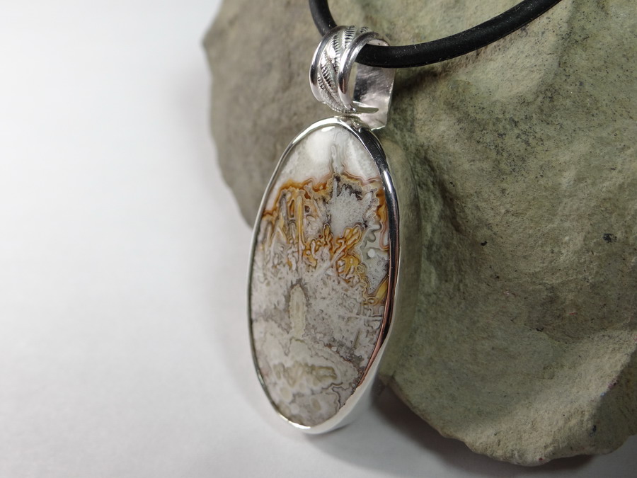

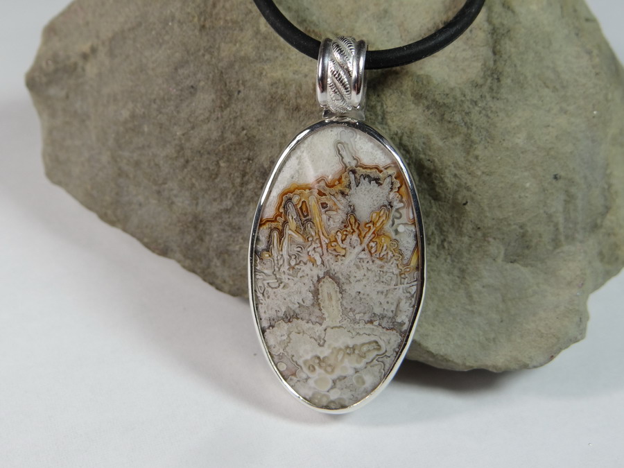

This one was all about persistence. I accidentally ordered 26 gauge bezel material instead of 28 gauge. The problems started right away. The thick bezel wire was difficult to even get pushed against the stone to get the length correct. I soldered it and it was too loose so I cut it at the solder joint and took some more material out to get it right. The whole time I was working on the bezel and soldering I knew the thick bezel was going to give me problems. When I put the stone in I tried using the bezel pusher with no luck. I then tried to push the bezel over using the burnishing tools also not much success. As a last ditch effort I ended up using the plastic end of my jewelers hammer and beat the bezel over. Not the best approach and I needed to file some marks out but I think I salvaged it. Lesson learned. I wont try that again. Thanks for looking Chuck

Looks like you worked through it pretty well, nice piece.
Post by rockjunquie on Dec 23, 2018 12:21:06 GMT -5
You wouldn't know by looking at it that it gave you problems.
Post by Bluesky78987 on Dec 23, 2018 12:26:08 GMT -5
All's well that ends well! I like your bail - gonna copy that.

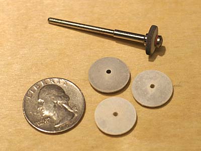

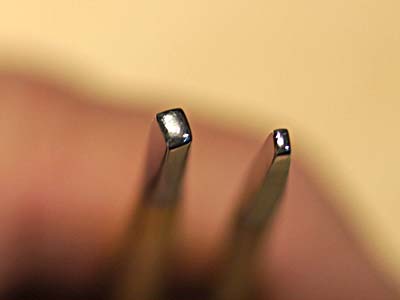

I routinely use 24 gauge for pendant and ring cabs, and 26 gauge for earring cabs. I just prefer the look of a heavier bezel (including 20 gauge if I'm setting a large faceted stone). And I hand hammer-set all cabs. Rather than use a hammer directly, to make it easier to control and limit marking the silver I use one of these two punches I made: Marking tends to be minimal and pretty limited to the edge of the bezel. Then I take my absolute favorite pumice wheel to take out the marks. They're white, knife edge wheels on which I've sanded a flat edge. They're fast and do a great job and you can go directly to tripoli polish or follow with fine wheels prior to triploli and final polish. I've purchased all of these pumice wheels on eBay — when they show up. I don't need any more, but there's a guy on eBay right now who has 6 sets of 20 wheels for a decent price: www.ebay.com/itm/Cratex-or-WR999-rubber-abrasives-Select-Wheels-Knife-sizes-grit/372053500550?hash=item56a01de286:m:m9ghEKcsk5hncaon3nfd_vQ:rk:12:pf:0
