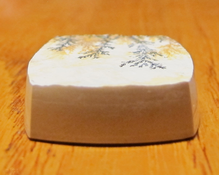

Post by rockjunquie on Jan 2, 2019 20:39:56 GMT -5
Here's a few visuals. This cab has a natural face and they are usually cabbed a bit thicker than normal, so you can (hopefully) make out the angle. Plus, I was able to trace around the top of the stone. The angle doesn't have to be drastic. You can just make out that the top sketch is larger.

40.22 mm long x 29.49 mm wide x 8.95 mm thick; girdle, ~9 mm per your Etsy shop
So you've "barely" flared it out.

Post by rockjunquie on Jan 2, 2019 21:08:40 GMT -5
40.22 mm long x 29.49 mm wide x 8.95 mm thick; girdle, ~9 mm per your Etsy shop So you've "barely" flared it out. That particular cab is different because the dome is flat. It's the angle I was trying to show. The flare comes from angle and is measured at the top edge of the cab and the bottom edge of the cab. I'll get you those measurements. Pat is right on. I usually eyeball it with my dopstick at about 3:00, so that's about 15 degrees. Sorry, I was wrong, it is more like 15 degrees for me. I know that sounds like gobbly gook right now. You'll get it, though. Just measured the stone- the top edge is 27.01mm; the bottom edge is 29.40mm. The difference is from the angle. If I knew math, I could figure it out. LOL! I just eyeball it. I'll PM you tomorrow about you and Susan.
