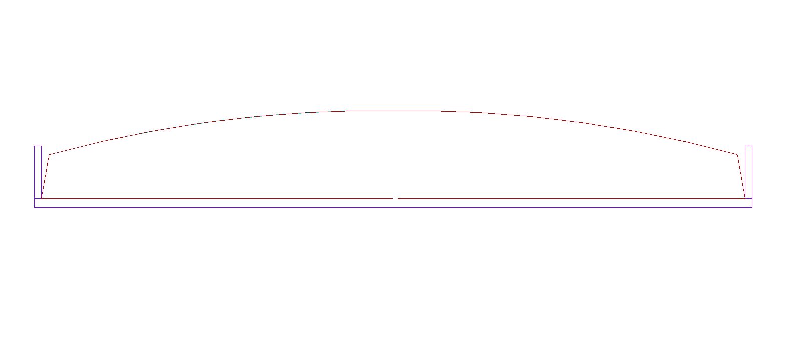

For what it is worth here is a quick cad drawing I just made to try to explain why we need the 12 degree angle for silversmithing. The cab is drawn in red and the soldered bezel in purple. After the bezel cup is soldered the stone is placed into it and then the bezel gets pushed against the stone all the way around which encapsulates the stone. I like to have a small amount of bezel protruding above the girdle so I can blend it over the cab a little bit. Chuck

Pretty lace! Ok and just one final clarification: Chuck, on your cad drawing I see the bezel and the domed stone with the girdle angle tilting outward. Do you also need the little bezel cut on the bottom edge for solder & to reduce chipping? So the stone looks like \_______________/ at the very base of the cab?

Post by Drummond Island Rocks on Jan 3, 2019 16:23:21 GMT -5
Pretty lace! Ok and just one final clarification: Chuck, on your cad drawing I see the bezel and the domed stone with the girdle angle tilting outward. Do you also need the little bezel cut on the bottom edge for solder & to reduce chipping? So the stone looks like \_______________/ at the very base of the cab? With that answer and maybe some comments from wrappers on the straight edge being easier I think this topic has been solved for me! Ya'll are amazing! Yes I always slightly chamfer the backs of all my cabs regardless of wrapping or setting. As far as the angled girdle with wrapping goes I just prefer the straight girdle because I pull my wires really tight to the outside edge of the stones. With a really high gloss angled girdle the stone wants to pop out as I try to pinch the wires around it. That is just my personal experience based on my style of wrapping. Forgotten to mention groove wrapping. For my groove wraps I would not be able to purchase the cabs. I want a sold 3+ mm of girdle and want the girdle at 90 degrees. Chuck
