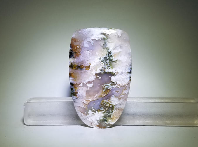

My resolution is... STOP BUYING ROCKS and thin out the herd I have. Honestly, I've been so addicted to buying/finding/cutting nice slabs that I could literally not buy a single rock this year and probably not make a dent in my preform inventory. In addition to a personal resolution, this is also a financial strategy for the year to come after the big move this month. My entry is a piece of Linda Marie plume agate that I bought last year in Quartzsite. I thought at the time how much it looked like a winter snow in the forest scene so it was my first thought when I read the the new theme.

Post by fernwood on Jan 6, 2019 15:22:37 GMT -5
Tommy I see what you saw in that beautiful cab. A wonderful winter scene.
Post by Bluesky78987 on Jan 6, 2019 19:48:36 GMT -5
That's a beautiful cab Tommy! I agree, it definitely looks like winter!
Post by rockjunquie on Jan 6, 2019 20:05:36 GMT -5
My New Year's resolution will be to cut a damn heart this year. I have yet to do one, mostly because I just don't like heart shapes- over done. But, I do need to accomplish one. Also, I resolve to enter a couple contests. And, to cab more often (which will mean telling my daughter she can not "just drop by"). Tommy, your cab is perfect! I definitely see/feel winter with that one.

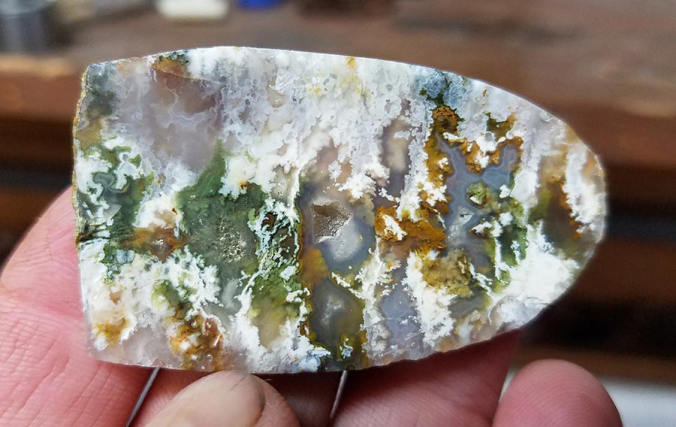

Post by NDK on Jan 7, 2019 21:55:20 GMT -5
I think this is a cool theme for this month, so I knocked out a cab tonight for the contest. Finished size is 2" wide, 1.5" high. I've got to say for a resolution I'd like to do more smithing. I sure need the practice! here's the slab, a 1 cab wonder Here's the finished cab - reminds me of a snowstorm my wife & I experienced in Colorado in May of '96 when we were trying to drive up to Durango
