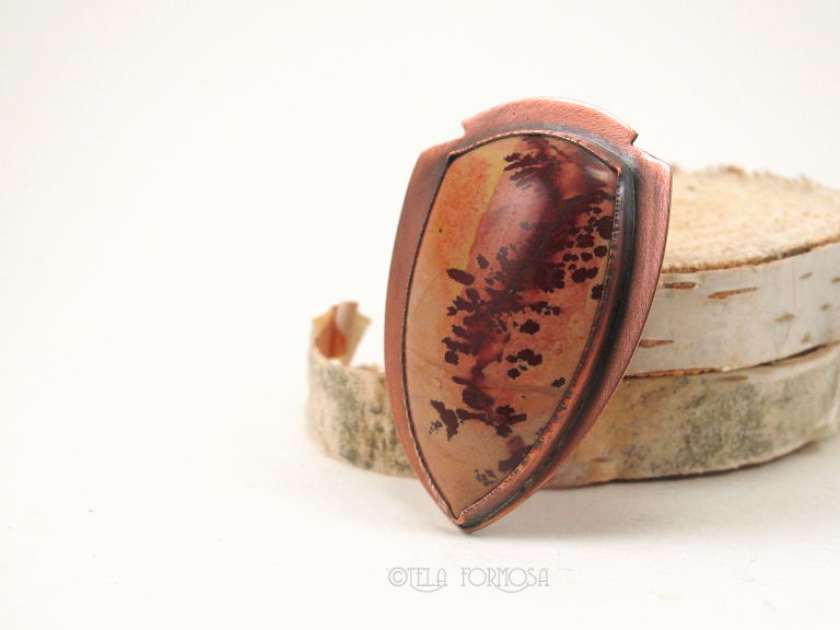

Post by lpl on Jan 8, 2019 12:39:17 GMT -5
Yes I really like the hidden bail idea, but here's something that I did a while ago. I cut a nice pear shaped pietersite cab that looked better oriented like your stone. It's a touch smaller than your malachite, but not much. I framed it in square wire and added an accent stone. Maybe you could do something similar? Really nice malachite! I'll look forward to seeing what you do with it!

Yes I really like the hidden bail idea, but here's something that I did a while ago. I cut a nice pear shaped pietersite cab that looked better oriented like your stone. It's a touch smaller than your malachite, but not much. I framed it in square wire and added an accent stone. Maybe you could do something similar? Really nice malachite! I'll look forward to seeing what you do with it! Wow, that's killer! I might try that modified a little.

Post by fireforged on Jan 12, 2019 14:26:10 GMT -5
That pietersite/lapis piece is killer. love the design.
