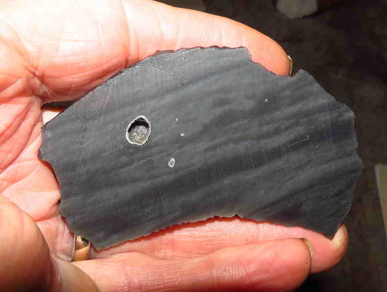

Here is a bubble in some silver sheen that will stay there when I throw it on the rock pile. I think there are a lot of small ones also.
