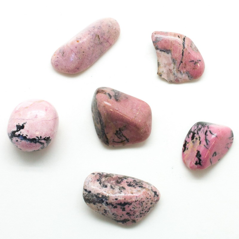

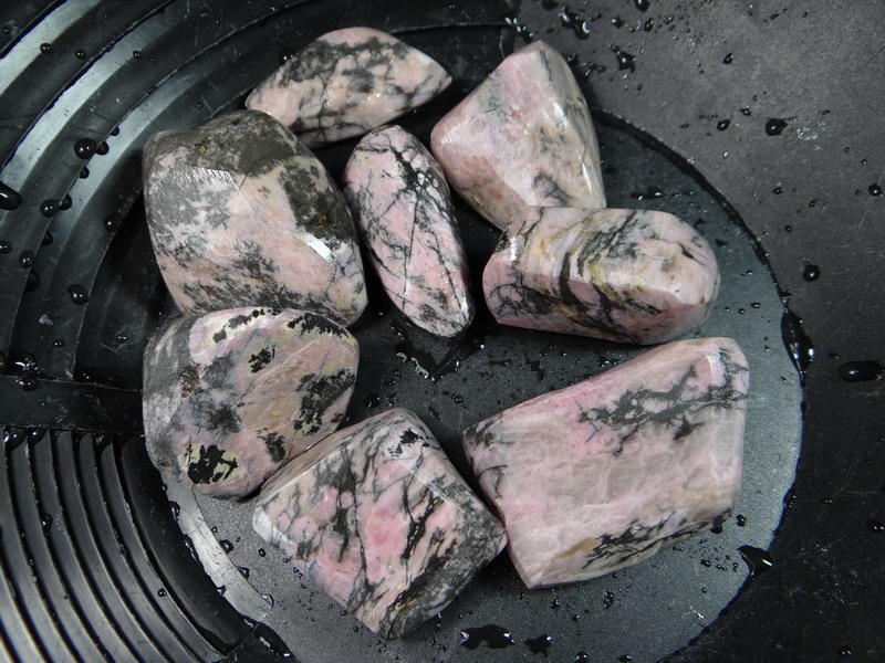

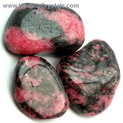

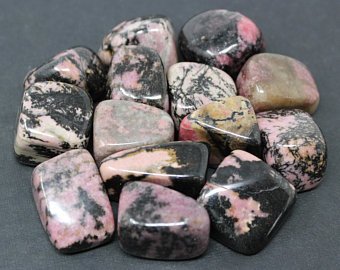

Post by Drummond Island Rocks on Jan 15, 2019 9:08:54 GMT -5
I have seen some that have a nice polish so it can be done somehow? Dont know how though I've thrown in 2 pieces of it with a batch and it came out matte finish while the rest of the batch had a nice shine I'm thinking it may need a different polishing medium ? While we are on the subject. Maybe a dumb question. Can it come in any color other than pink? I agree. All of the pieces I have tumbled have just been in mixed batches. Some experimenting in a dedicated batch will be required. It is a mixed hardness material so that always adds to the challenge. This just shows the varying types. The pieces I have tumbled were the gemmy kind like the last two pictures. Chuck

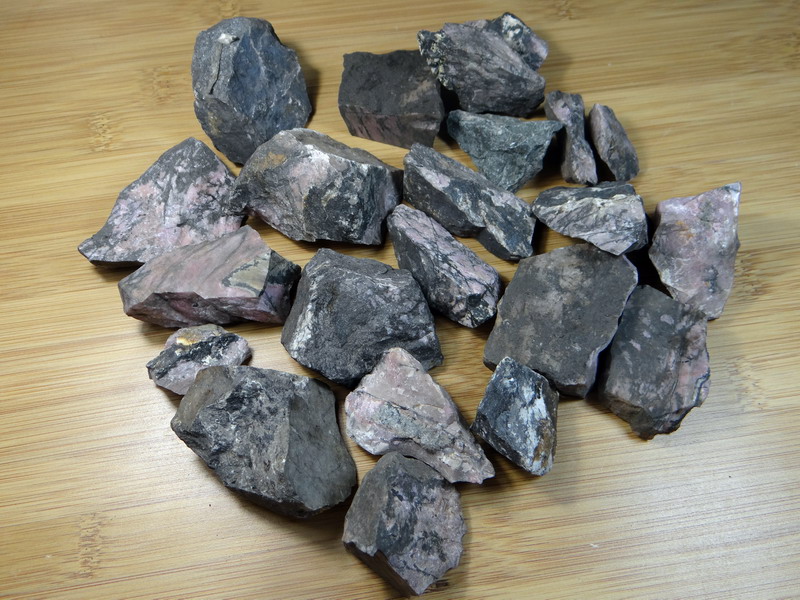

Post by Drummond Island Rocks on Feb 28, 2019 22:48:48 GMT -5
TommyI entered and received my rocks 2-20. They are officially rolling for the first week right now. I changed things up a little bit and did some hardcore pre-shaping this time. I normally do not do much grinding on the contest rocks. All of these pictures were taken on the same day I received the rocks. This should be an extremely fast stage one tumble. The challenge will be getting a good polish. straight from the box After an hour in the loto with borax to clean off the dust and dirt After pre-shaping Chuck
