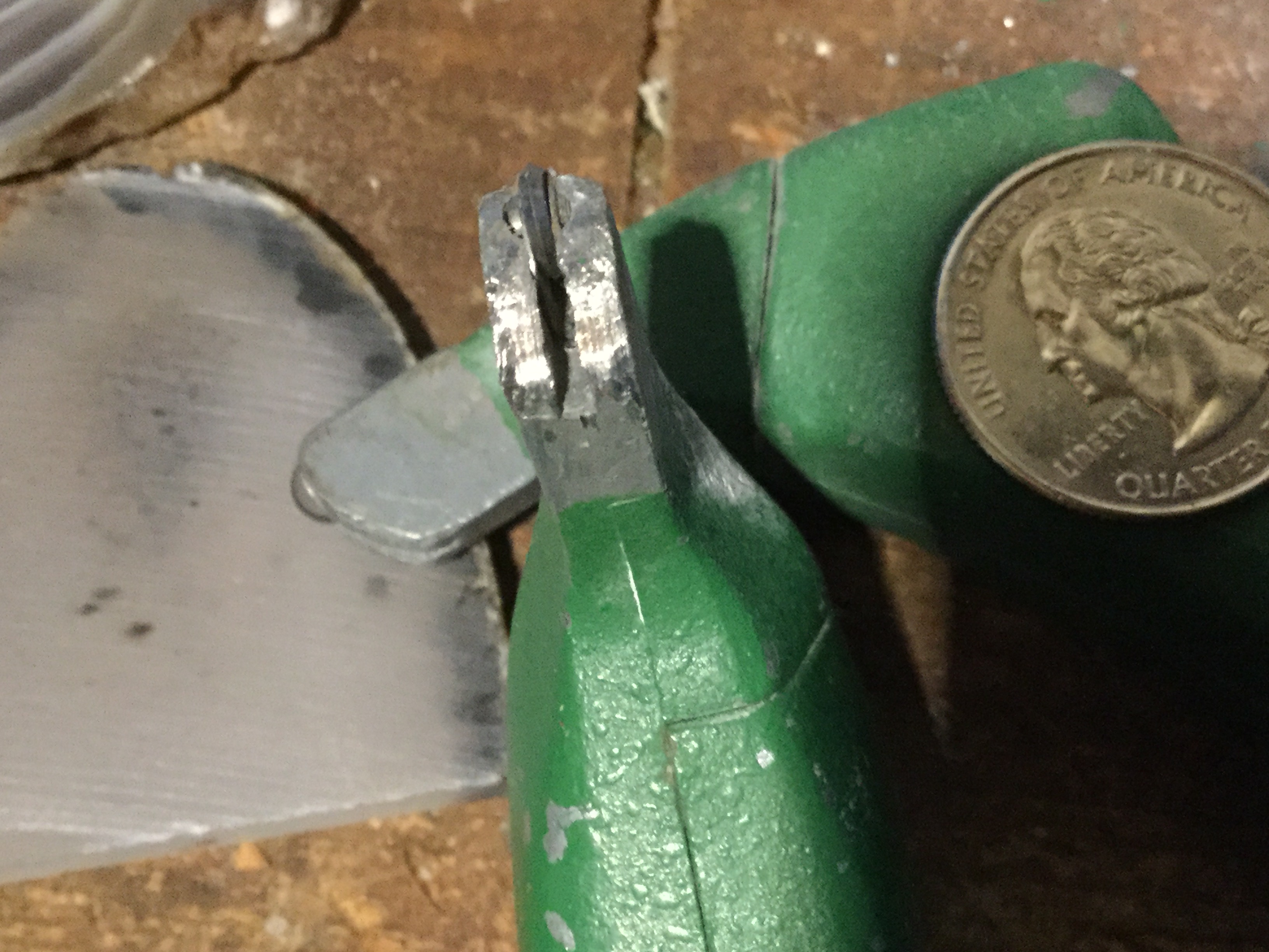

miket That’s exactly what I have. I actually have two of them. They’re very efficient at trimming slabs. MsAli The cutter just scores a line on the slab with a tiny carbide wheel. It essentially makes a weak spot on the slab. I then put it in a smooth jaw vise and push, breaking the slab on the score line. I’ve learned to wear gloves when doing it because sometimes the slabs have sharp edges when they break. Here’s a picture of the carbide wheel. Photo shows one from the side and one from the business end. Here’s a video on cutting glass. It’s the same idea. I don’t usually tap the slab after scoring, but I will give it a try next time.
