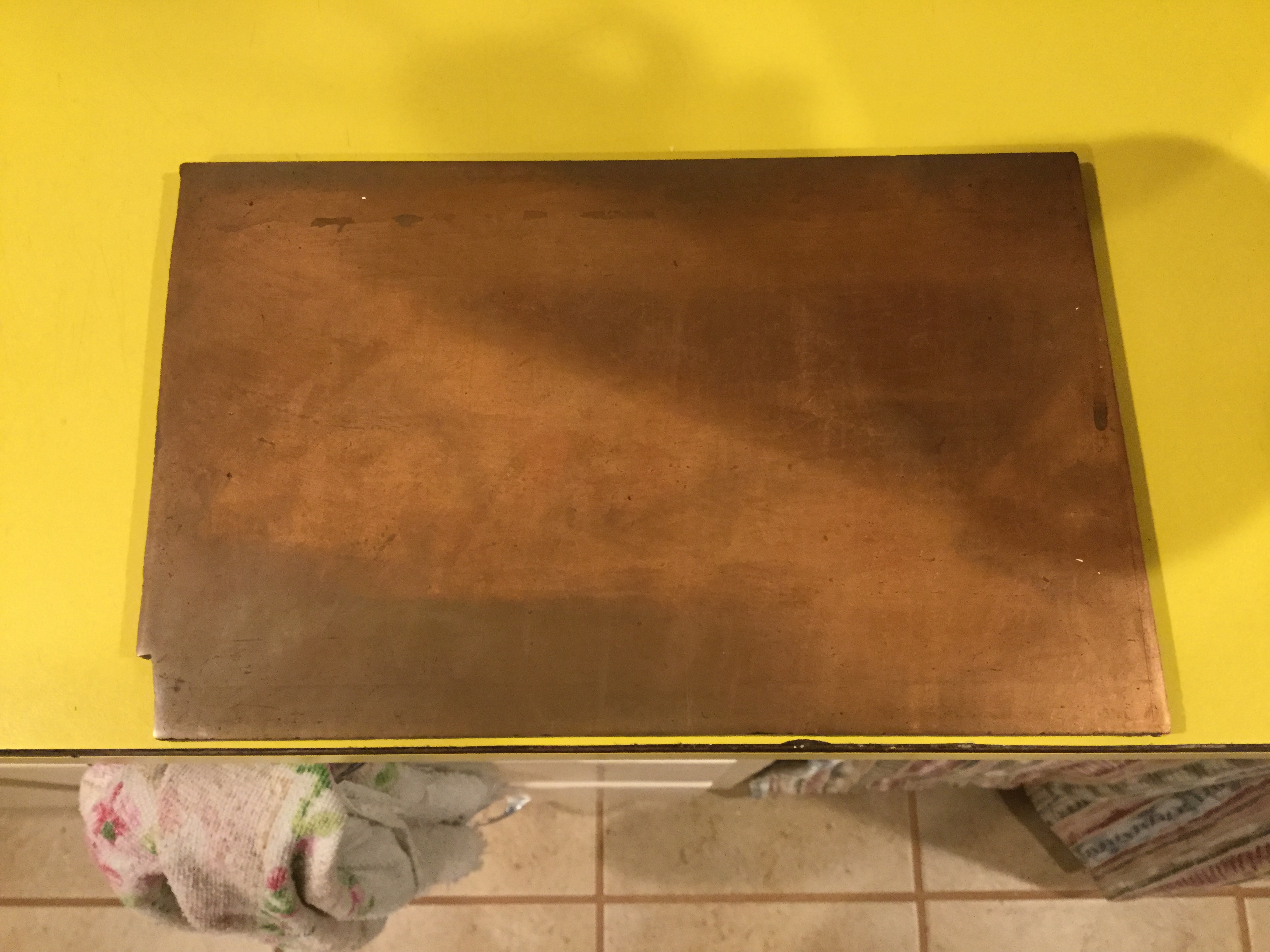

I have a 1/4” piece of copper plate that always stays cold. Once my wax is warm, I dip, swirl and plant them on that thing. It cools, the dop wax down fast. I do several dops at a time. Heat the stones with a a hot lightbulb on a cast iron ashtray.

I also like waxing new dop sticks ahead of time like that. Especially for larger cabs. The flat wax surface helps me get the dop sticks perpendicular to the stone more reliably.
Our "equipment" is different. I really like that copper plate, but I get by with a 3/4" thick polished granite countertop sample. For heat I've used electric "mug warmers". Little hot plates that hold four 40x30 preforms. They don't heat up too fast, and cool down quickly.
