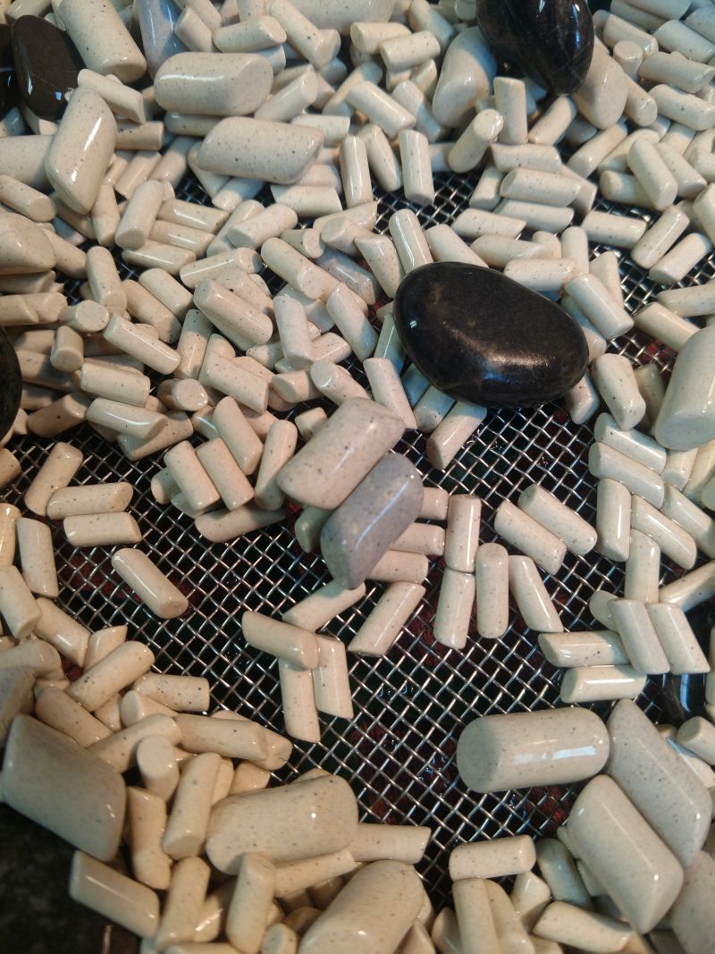

I ran some large cylindrical ceramic media (3/8 x 5/8 taper cut) in my rotary with SiC 60/90 (I forget why I did that), but anyhow. Some of them turned grey. Not many of them.
Does this indicate they are porous and shouldn't be used for trying to get an awesome polish on stones?
Also, is it normal for them to have large black flecks in them? Around 1mm.
I'm going to be buying some more, enough to have a good amount for just SiC 150/220, and then another amount designated for AO 500 + polish stages in the vibe. But I was just curious.

I wouldn't worry about it. Did the tumbled stones look okay after completing the stage with the ceramic media? If so your ceramic media is okay. The black specs are probably flaking off a new tumbler bowl which is common. Did you get the black specs floating on top of the slurry when you finished the stage?

I wouldn't worry about it. Did the tumbled stones look okay after completing the stage with the ceramic media? If so your ceramic media is okay. The black specs are probably flaking off a new tumbler bowl which is common. Did you get the black specs floating on top of the slurry when you finished the stage? The rocks took a nice polish in AO 500, so I didn't do the polish stage (yet, anyway).
The black flecks are embedded in the ceramics, and are revealed as they wear down slowly. Most likely impurities I guess. I'm just hoping they are not abrasive impurities. The tumbler barrel is rubber and I don't see any bits of rubber anywhere when I tumble, after the initial run when it was brand new.

If I recall correctly, what you are describing indicates you may have abrasive ceramics. I don't have the specs on them, but I would only reserve those for a coarse grind, especially if you don't know the size of the grit that's embedded in them. Where did you get the ceramics?

Here are a few photos showing some that turned grey and you can see the flecks of dark material in a lot of the media I purchased all of the large and half of the small from rocktumbler.com and the other half of the small from the rock shed. FWIW I don't think any of the small media I got from the rock shed displays any abnormalities or discoloration.

While I can't say for sure, I don't know if those are abrasive or not, as I've never used or purchased the material. Most ceramic abrasives are used in metal finishing/deburring, but since you bought your stuff from lapidary suppliers, I would actually be surprised if those were abrasive. Perhaps an email or phone call to your vendors might alleviate your concern(s). Just for grins, I did a search and came up with this page where abrasives are sold. In the photo gallery below the main photo, there is a photo of some abrasive cylinders. While similar in appearance, they don't quite look the same as yours, as the flecks in theirs appears to be more prevalent, IMHO. Perhaps jamesp can offer an opinion.

Yeah, the particles are not very uniform in size or density. I got a nice polish in AO 500 with them so I'm not really concerned, just wondering what the heck. They certainly were all pure white when new.
I just ordered 5lbs more from Shawn at The Rock Shed. Perhaps his are higher quality.
Post by aDave on Dec 5, 2019 20:00:02 GMT -5
Yeah, the particles are not very uniform in size or density. I got a nice polish in AO 500 with them so I'm not really concerned, just wondering what the heck. They certainly were all pure white when new. I just ordered 5lbs more from Shawn at The Rock Shed. Perhaps his are higher quality. I did not realize you went that far with the ceramics you have. I thought you'd only done 60/90 with the stuff. Considering your results, and the fact the media does not look the same as the abrasive laden material, keep on rolling.

This is one explanation for black specks in ceramic media EricD aDave2nd paragraph - www.pfonline.com/articles/aluminum-oxide-impregnation(1)"Fused aluminum oxide is made by fusing iron filings with alumina in an electric arc furnace. This is the black granular stuff used for roofing and floor grit, grinding wheels, and, you guessed it, the little black specks you see in tumbling media. It gives the cutting power to the media." Ceramic media is most commonly fused aluminum oxide because it is cheap and effective. Other ceramics are zirconium oxide, or tin oxide and others. However fused aluminum oxide media that is fused with silicon carbide will have black specks in it too. 100's of grades and compositions of ceramic media from aggressive to polish so beware. Ceramic media sold at rock tumbling stores are polish grade thankfully. Buying rogue ceramic media is a bad idea. If it is an aggressive grade you will not only never get a polish but will kiss your vibe barrel goodbye. If it is high density aggressive cutting zirconium oxide media it will really eat you vibe barrel fast. High density ceramic media throws a harder punch/vibration(i.e. shot peening). Known for bending soft metal parts in a metal finishing vibe. A 4 pound Lot-O will hold about 9 pounds of zirconium oxide media which would probably break it's springs. Agate has 2.7 density, ZO about 6.2. 6.2/2.7 x 4 = 9 pounds. AO density is only 3.9. Steel is 7.9. I don't use ceramics. They take longer than softer Mohs 7 media to get 500-1000-polish finishes because it is so hard at Mohs 9. To each his own.

I received some well used, small triangle ceramic media as part of a bulk purchase. The ceramics had black particles in them. SEller told me that the black flecks were in the media when they were new. I separated the used and new ceramics. Now have stage specific. Some now have a high polish.

I bought my ceramics from the same source and mine have the same discoloration/specks. Since I'd never used ceramics before, I thought it was the norm. I was able to see it when they were wet, before I tumbled anything with them.
