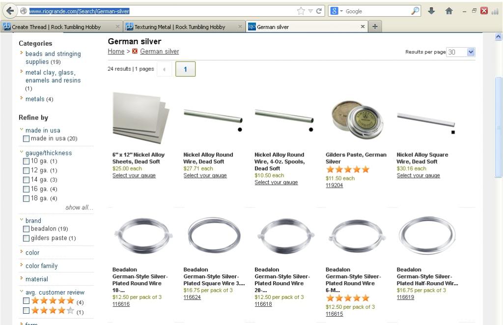

Post by 1dave on Nov 25, 2013 7:50:12 GMT -5
Cu 60%, Ni 20%, Zn 20% - also in other alloys that melt at lower temperatures, but usually around 1450 oC, 2642 oF. It contains NO silver, and is very difficult to cast. It is often used in jewelry because it is inexpensive, looks good, is the same color as solder, and even bezels are nearly impossible to be melted and ruined by beginners. www.riogrande.com/Search/German-silver With a little begging, I believe jamesp could beat these prices ?? I prefer the term "White Brass" because I feel the other two, although most often used, are misleading.
