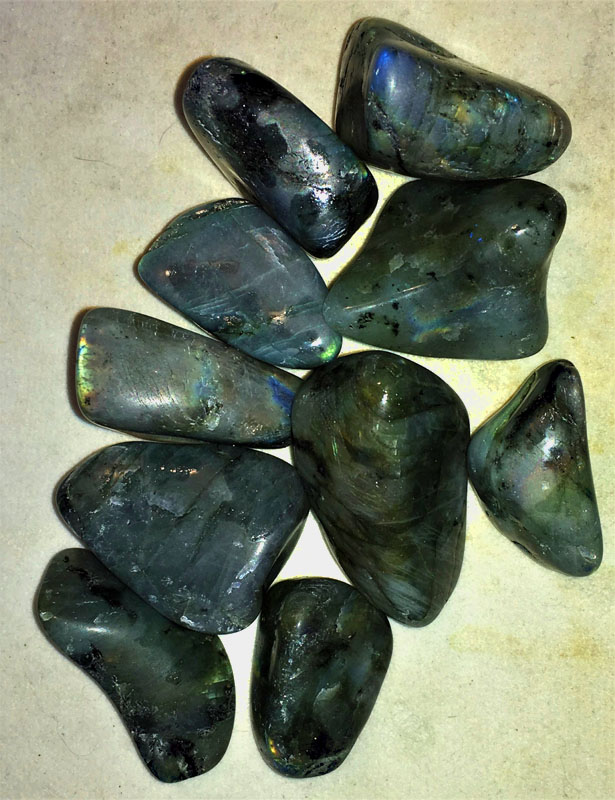

My Labradorite just finished the pre-polish with 500 SC and LOTS of plastic pellets - Lookin' good!
Here it is wet...
And here it is getting dry...
