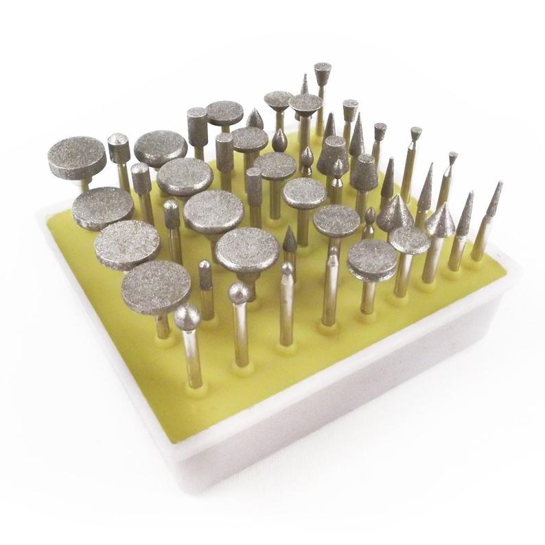

I use the diamond tire burrs. I'll try to post a pic later, pm me if I forget or if you have any questions, I'll be glad to help! π
Post by miket on Sept 13, 2020 7:21:13 GMT -5
I use these. I usually try to get them on jadecarver.com but he's been out for a while... I use them to shape though, not polish. Mine get polished in the tumblet. oldschoolrocker might be able to give you better advice.

for shaping I use 50mm diamond cutting discs and for sanding and polishing I use silicon carbide sandpaper and then alum oxide polish . the cutting discs are very inefficient usually only get maybe a cpl cabochons shaped before grinding slows way way down. for something as large as the stone in the picture bits like miket suggested are a better choice. but anything that large and rough is going to be quite the task with a dremel

All great responses. The wire brush can be used to clean a rock, but kinda useless for shaping or polishing. I tried to expose silver ore on some rocks and really only managed to wear out some brushes. Diamond or carbide bits typically work better. I don't have the patience to use a Dremel on large rocks and respect anybody who does. ;-)
