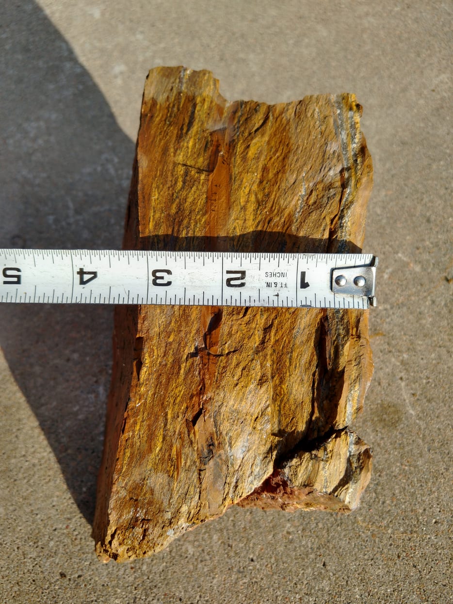

For some reason I'm on a mission to create the best Tiger's-eye tumble I can. It's like I've chosen it to be my benchmark stone for monitoring my tumbling improvement. There's this previous one, a few little blue ones, and a 1 lb red one that's grinding I haven't shown. They're fun - it's a pretty stone. The thing is for these gold ones, I keep picking bigger ones each time! This time it's too big to fit in the barrel. I knew when I picked it up this past summer that I couldn't tumble it until I got a saw. Well now I have a saw... dun dun duuuunnnn! ...and an angle grinder with a masonry disk... Dun Dun Duuuunnnn! ...and a 12 lb barrel that'll be open come Friday evening... DUN DUN DUUUUNNNN! I'm showing what I did to it today, kind of setting the stage. I am still pondering what all I'm going to do with it before it begins tumbling. The problem with the previous one I did was that it was thin (wrt its length and width) and to see the flash the stone either needs to be picked up or propped up at an angle. I'm pondering shaping this so that the flash can be seen looking down towards it, where the sides are at an angle. Kind of shaped like a pyramid with the top cut off. The top and bottom brown capstone material isn't very thick and I'm thinking of hitting that both sides with the grinder. Alright, stone wont fit in barrel because it's too long. To remove the least amount of material to get it to fit, I decided to knock the sharp tip off the end. There's a couple other sharpie lines here where I trimmed off the high spots that created concave areas not conducive to tumbling. For reference this weighed 2922g (6.44 lbs) before I started cutting. Which is 2.8 times the initial mass of the previous one. Hold my beer... Laser eyeball the second pass... Not bad. I'll show more as I go, then do my usual rigor with a set of week 0 pictures that track as the tumble proceeds.

Looks cool!
Australian tiger eye? (vs. African)
What are you going to tumble with the large piece?

Nice. I have never seen a slab that thick. Bet a slice or two would make beautiful cabs for a pendant.

Looks cool! Australian tiger eye? (vs. African) What are you going to tumble with the large piece? Thanks! I'm leaning towards Australian based on what Shawn lists on therockshed. That's a guess though since I don't have the original listing anymore, but that's where I got it. For the coarse grind the barrel will be filled with assorted stones that need tumbled, like jaspers, agates, chalcedony, etc. Once it's ready for stage two the material will be swapped exclusively for my pretumbled sacrificial quartz, which will follow it through to polish.

Nice. I have never seen a slab that thick. Bet a slice or two would make beautiful cabs for a pendant. I'm holding onto the chunk I cut off until I come up with a plan for it. It's kind of a triangular prism shape, but I could get a good slice or two from it. I'm kind of on a fridge magnet kick right now, with some 1/2" x 1/16" N48 neodymiums on the way. We'll see, haven't decided yet.

I love your "big" tumble threads! That really is a killer piece of Tigers Eye! (Not gonna lie...I would've sliced off some slabs for some amazing cabs out of that one! )

That one is (pre)shaping up nicely! I like what you’ve done with this one so far and am looking forward to following this big fella’s progress.

I don't know about tumble. I think I would take the preform with all the angled faces on them and polish each up. Then use as a specimen on a turntable in center of my display.

Week -1: Precut/pregrind 2922g. Week 0: 2310g (5.09 lb) Going into 36 SiC with miscellaneous material, such as jasper, chalcedony, quartz, and most of the cutoffs from the original stone. Four sides, rotated 90 from each other. Bottom Getting a decent angle on the chatoyant area. We'll see how well the first week gets the angle grinder marks out. Decent fit. Let it rock.
