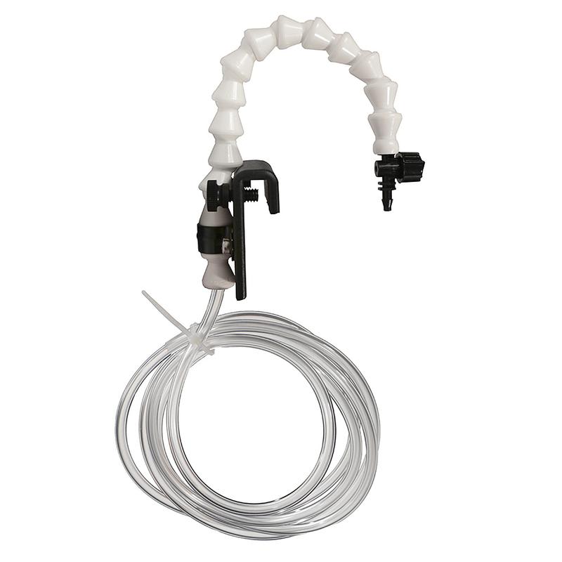

Post by rewdownunder on Nov 23, 2021 14:15:21 GMT -5
This is what I use for extra water on several tools. You can buy it or make one and just add a small pump and a bucket of water. For some tools you need to add a drain or a larger pan to hold the water This one is from HiTech Diamond.

Post by hummingbirdstones2 on Nov 23, 2021 18:59:12 GMT -5
There ya' go!
We got those systems from Hi-Tech for our flat laps and like them a lot. As rewdownunder said, you could make your own setup easy enough.

Post by rewdownunder on Nov 24, 2021 13:06:22 GMT -5
Just saw that Hi-Tech Diamond is having a 25% off Black Friday sale. Great time to get one if you do not want to make it yourself. ( I hope this is OK to post, I have no interest in the Company)
