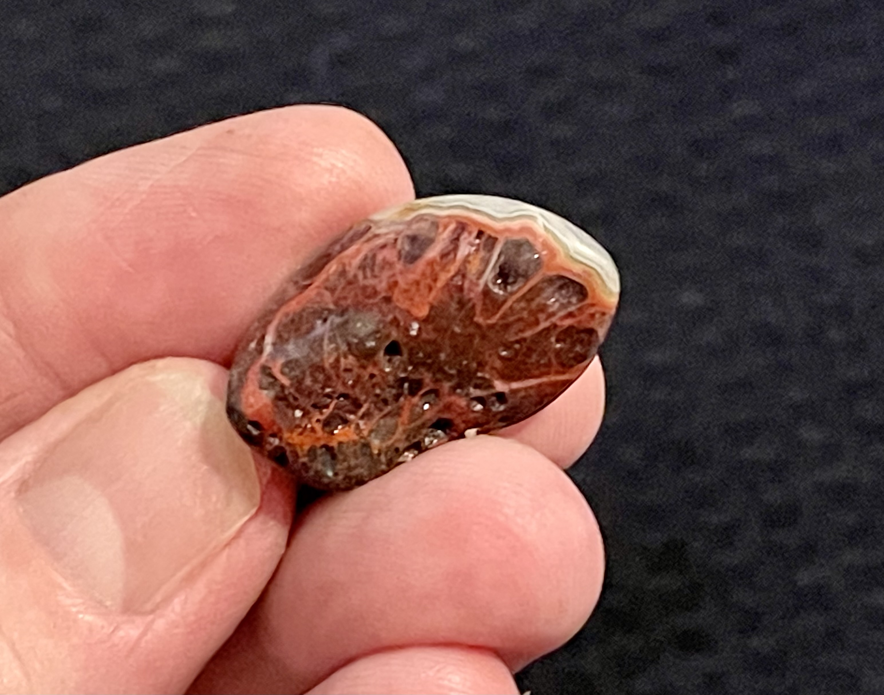

That little piece is awesome! I've tossed saw scraps in with tumbles in the past...and it seemed like the small pieces were the coolest of all! LOL

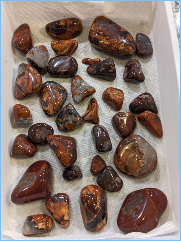

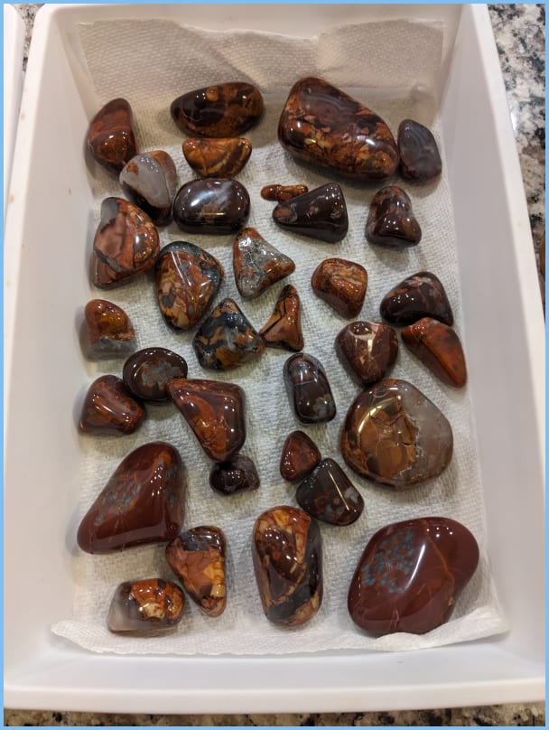

So, I started these back in June which means they spent ~5.5 months in coarse grind. I then moved them to the Lot-O for 2 rounds of 220 (2 days each), one round of 500 grit AO (3 days), pre-polish AKA Tripoli Powder(4 days), Rock Shed polish (4 days). Pic of results below. So, the question was: Are cold Mountain Thundereggs a good material for tumbling? Simple answer is - no. That said they are fun, challenging, beautiful, and take a good shine. But, as jasoninsd pointed out they are fairly unstable, and contain several voids/cracks that get exposed as you tumble them. Additionally, places where agate meets the Jasper often have voids or seams that are not smooth or uniform. I had mine tumbling for over 5 months, and I would have tumbled them down to nothing if I tried to get them perfectly smooth. All that said I would tumble them again - they are challenging/fun and have cool patterns - I just need to adjust expectations in terms of how uniform I can get the surface. I think out of this batch only 3 had uniformly smooth surfaces. Here are some pics of the batch below. I will try to highlight some of the cooler ones when I get back from Arkansas.
Post by jasoninsd on Nov 18, 2023 21:51:58 GMT -5
Holy Crap! Were these really started that long ago? (Rhetorical!) I remember when we discussed these...and would've guessed only a couple months ago! Sheesh time is flying!!
I was REALLY hoping you were going to have better results on these! There's still so many gorgeous colors mixed in with this material...which always suckers me in to working them time after time...with the same crappy results! LOL - I've only had a handful of cabs work out! Arghhh!!!

Post by jasoninsd on Nov 26, 2023 18:28:51 GMT -5
Love the individual pics Dillon! Dang you though! Every time I see "good pics" of this material, I get the itch to work it again...only to have my heart broken 9 out of 10 times when I actually do work it! LOL

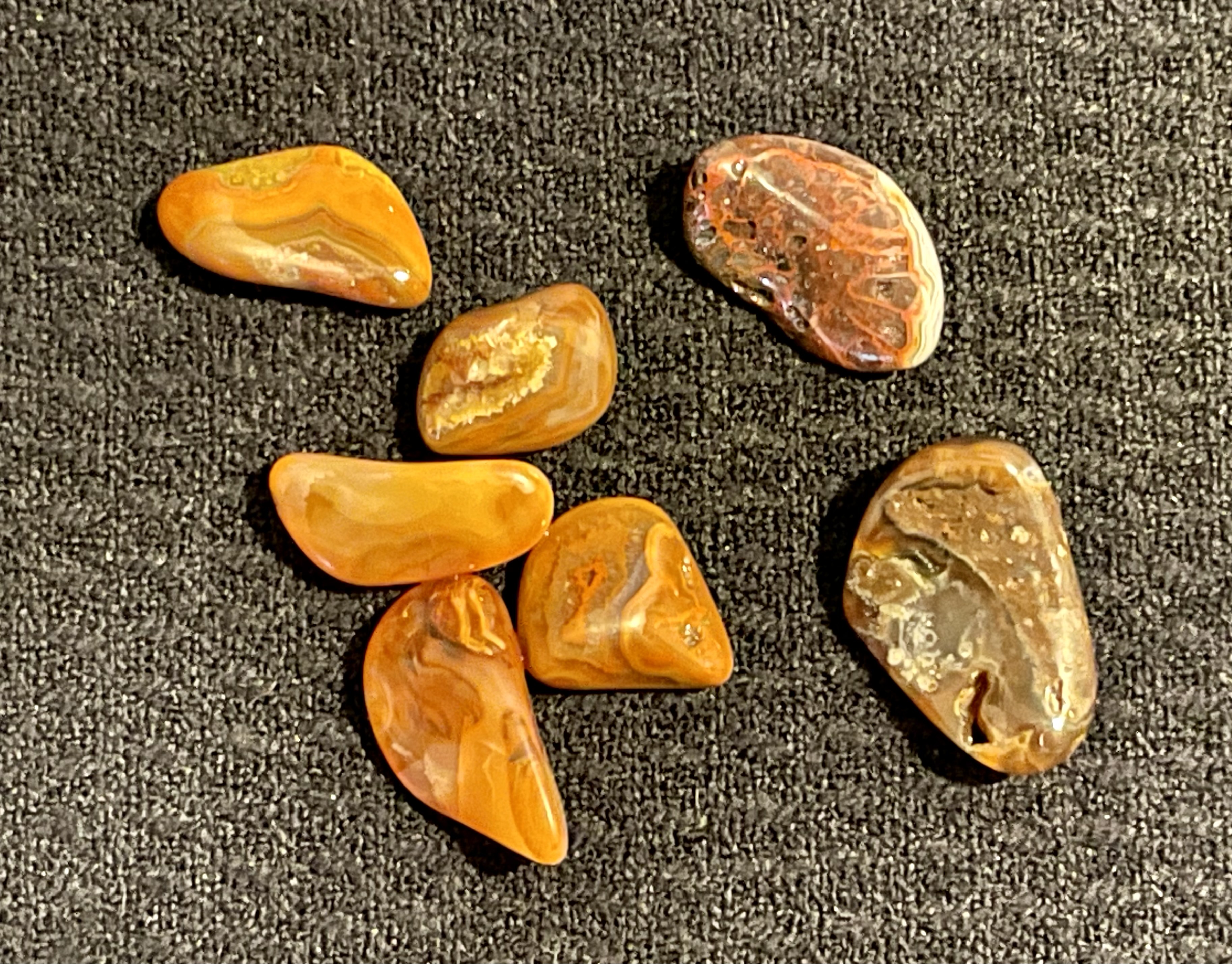

dillonf Those look very nice bud! I’m tumbling a couple of Blue Boy (Bell?) thundereggs I got from Richardson ranch and they are now pretty round and the size of a large golf ball. Really interesting. I’ll post photos at the next clean out when I’ll be moving them on to stage two. I’m hoping that there’s just enough matrix left to make them look like weird plants lol, they were nearly there this last clean out. Thanks! That is cool you are tumbling the Blue T-eggs! Can't wait to check out your photos! On another note we were talking about running some Fire Agate in the vibe to see if we could get that cool iridescent sheen out of it. For the life of me I couldn't find that old post . . . If I remember correctly you got it to work on one of your pieces - I ran 3 pieces in the vibe with ceramic from 500 to polish - didn't work for me
Post by velodromed on Nov 26, 2023 22:28:02 GMT -5
dillonf Those look very nice bud! I’m tumbling a couple of Blue Boy (Bell?) thundereggs I got from Richardson ranch and they are now pretty round and the size of a large golf ball. Really interesting. I’ll post photos at the next clean out when I’ll be moving them on to stage two. I’m hoping that there’s just enough matrix left to make them look like weird plants lol, they were nearly there this last clean out. Thanks! That is cool you are tumbling the Blue T-eggs! Can't wait to check out your photos! On another note we were talking about running some Fire Agate in the vibe to see if we could get that cool iridescent sheen out of it. For the life of me I couldn't find that old post . . . If I remember correctly you got it to work on one of your pieces - I ran 3 pieces in the vibe with ceramic from 500 to polish - didn't work for me I just finished up with the fire agate thing. I started the day we discussed it tumbling in a small 1lb barrel for a long time then the vibe for near two weeks. I’ll post pics soon of my results, which I’m a bit confused about right now and need to sort out first.
Post by velodromed on Nov 27, 2023 12:59:44 GMT -5
Yeah. Thats it. Just one holds any interest really. Won’t be trying that again lol.
