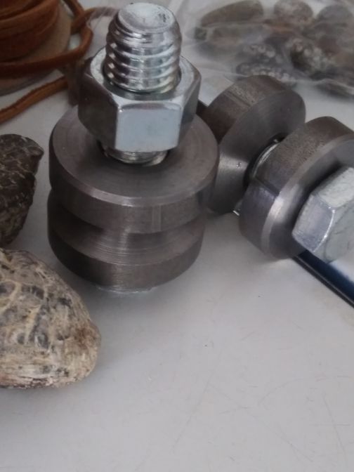

Yes, I have it and set it up in a vise. I think it will work fine. Before I use it, I am going to texture the metal. Hmmm, could also do a dry run on a plain strip. I'll post when I do it. Not today : ) toiv0

Got my ring flaring tool yesterday and havent tried it yet.
Post by Pat on Dec 25, 2018 11:27:03 GMT -5
Are the two disks curved on the facing sides?
Did you make it?
Post by Rockoonz on Dec 25, 2018 12:48:48 GMT -5
What angle are those turned to? Those would be simple to turn on one of the lathes at work, the ring sized ones I could do on my little lathe at home. The pieces in your pic aren't even polished like I would expect a decent quality jewelers tool to be. Also I would scrap the cheap coarse thread grade 5 bolt and nut for a same diameter fine thread grade 8 bolt. The fine thread will give you better control over the process with less force required on the wrench.

Post by toiv0 on Dec 25, 2018 13:04:26 GMT -5
Are the two disks curved on the facing sides? Did you make it? yes they are beveled on facing sides. I didn't make it, bought it, only because it was only 10 dollars. Here is the site. www.potterusa.com/
Post by toiv0 on Dec 25, 2018 13:10:33 GMT -5
What angle are those turned to? Those would be simple to turn on one of the lathes at work, the ring sized ones I could do on my little lathe at home. The pieces in your pic aren't even polished like I would expect a decent quality jewelers tool to be. Also I would scrap the cheap coarse thread grade 5 bolt and nut for a same diameter fine thread grade 8 bolt. The fine thread will give you better control over the process with less force required on the wrench. I was planning on replacing the bolt, not sure of the angle, have nothing to measure it with and my math is not so good looking. I agree also on the polish but you get what you pay for.(10 bucks), I have been using dapping punches but wanted to be more consistent. Would like a larger bracelet one eventually.
