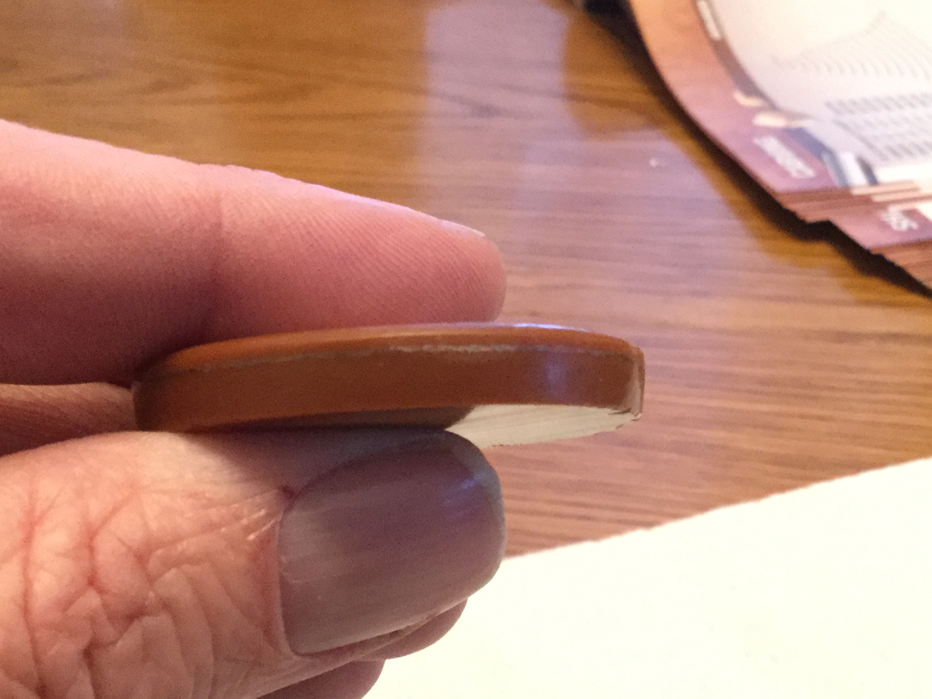

Post by holajonathan on Oct 11, 2021 12:42:42 GMT -5
holajonathan Do you mark your girdles? I always use a sharpened aluminum rod to mark my girdle thickness. After flattening the bottom of the preform and chamfering it I mark the girdle by laying the aluminum rod on a flat surface and then rotate the preform,(bottom down) around the marker. That marks a girdle line around the circumference of the preform. The mark should be a uniform height above the bottom of the preform. I then grind three bevels on the crown trying to maintain the same angles all the way around the crown being sure not to cut past the girdle line. I check my accuracy by looking at the freshly ground bevel. It should be a similar shape to the original preform. Once the three bevels are cut, I start rocking the preform back and forth to remove the high points from each bevel on the crown. Once the crown is fairly uniform, I go to coarse sanding. I spend quite a bit of time on the coarse sanding stage to make sure the crown is a uniform dome. Then on to fine sanding and polish. This method usually results in a pretty flat dome, with a uniform girdle. I use my finger tips to check the consistency of the dome as much as I use my eyes. The biggest trick is to never grind beyond the girdle line on the circumference. It works pretty good on rounds, ovals and freeforms. Go light and slow on finer points of free forms as rockjunquie said. You can get rid of the circumference line on fine sanding and/or polishing but it usually results in a nice sharp girdle line. Great question. Sorry about the long, drawn out explanation. I’m sure everyone does it a little differently. Feel free to PM me or ask questions in this thread if something I described isn’t clear. I remember struggling with well defined girdles and uniform domes. Here’s a picture of an oval preform with the circumference girdle line. In this case, the dome would be on the side held by my thumb. I’m looking forward to seeing some of your results. sincerely, Brent. Thank you, Brent. Your explanation is similar to what I have received from others, but I appreciate receiving it again in a slightly different way. I do mark a girldle line, and with ovals, tear drops, and similar shapes, I have no problem staying above it. Cabs with long flat sides, inside curves, and sharp points, are what have been throwing me for a loop. When it came to cabs with long points, for example, I had to choose among 3 options: (1) let the girlde get shorter at points (to allow the dome to continue to fall to the end of the point), (2) leave something of a ridge along the top of the point, which allows the girldle to stay consistent; or (3) have a flat spot in the top of the cab running in the direction of the point, if that makes sense. rockjunquie and other seem to use option #2, as well-illustrated in the photos that she posted for me in a separate thread. You said "I check my accuracy by looking at the freshly ground bevel. It should be a similar shape to the original preform." I think you mentioned that to me before, and I have come to love doing that. Assuming the angle of the bevel is consistent around the cab, this is a fail proof method. If you make cabs with geometric shapes, flat sides, or long points, I would love to see a few photos when you get a chance. I may create a thread asking the entire community to share such photos so that I and others may learn from them. I appreciate your willingness to help guide me in the right direction. I'll continue to post photos of my progress.
Post by rockjunquie on Oct 11, 2021 12:48:58 GMT -5
holajonathan The only cab that had ridges at the corners was the first one. If any others looked that way, it was reflections. Just wanted to make that clear. It is generally preferable to NOT leave a ridge.
