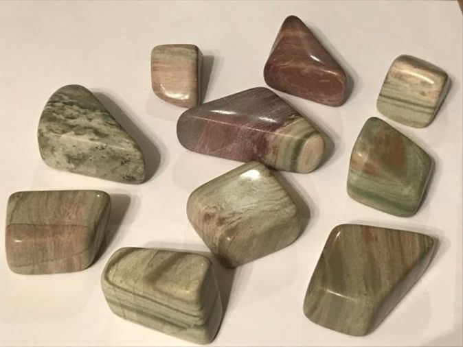

Post by Bucknutty on Jan 7, 2019 23:08:07 GMT -5
I've had decent luck with marble. These have been sitting in a jar for over a year with some harder rocks, so they've lost some of the shine, but they came out of the tumbler pretty nice. Skipped the coarse and did 2 days each 220/600/polish. You loose a LOT of material with the 220, so you have to fill in with something before the next stage, but it's solid, so there are hardly any cracks or pits, which is more than I can say for any of the harder stuff I've tried. I've got another batch in right now (ran out of coarse grit, so I needed to kill a few days on something that didn't need it until the grit arrives)
