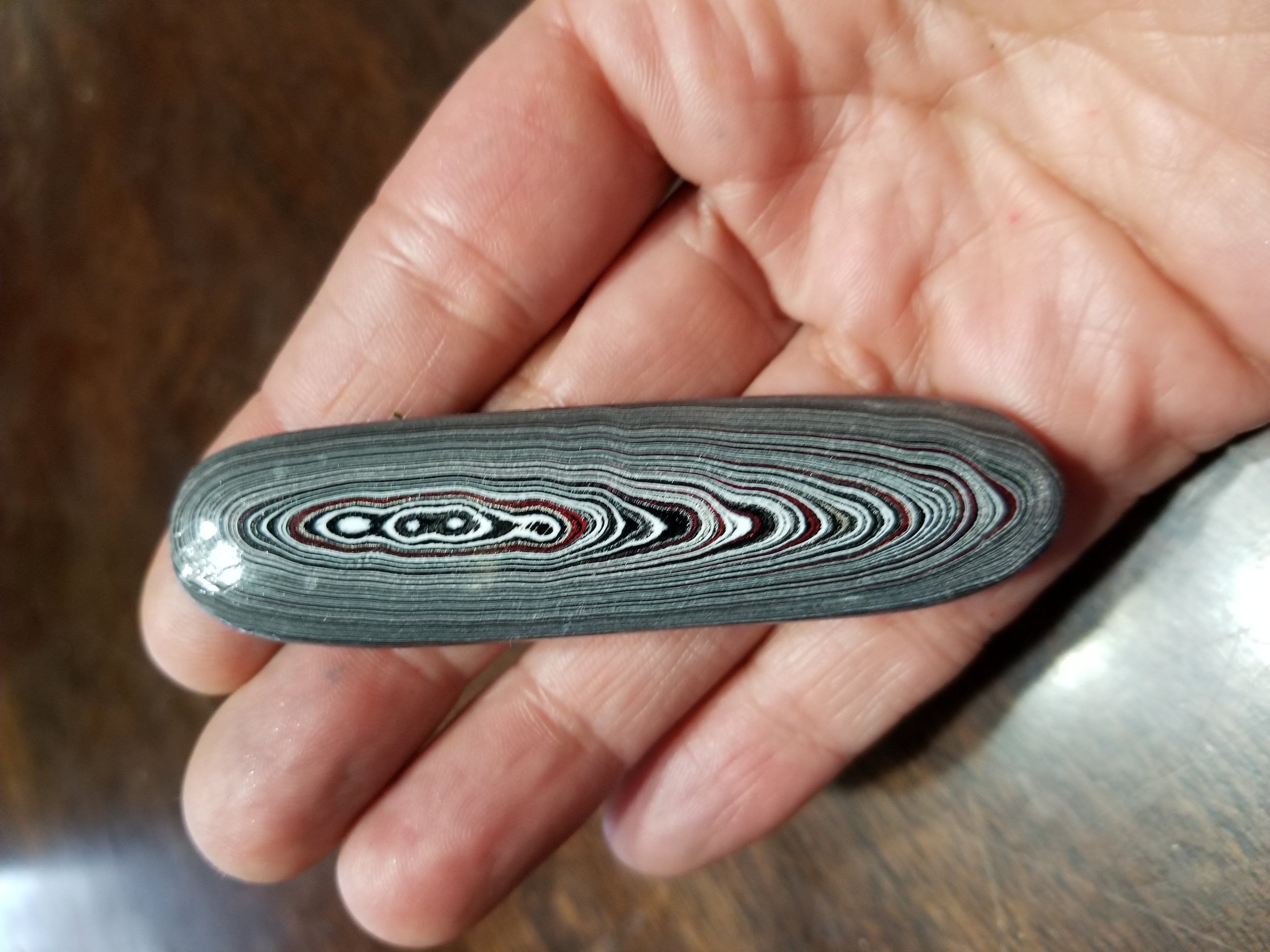

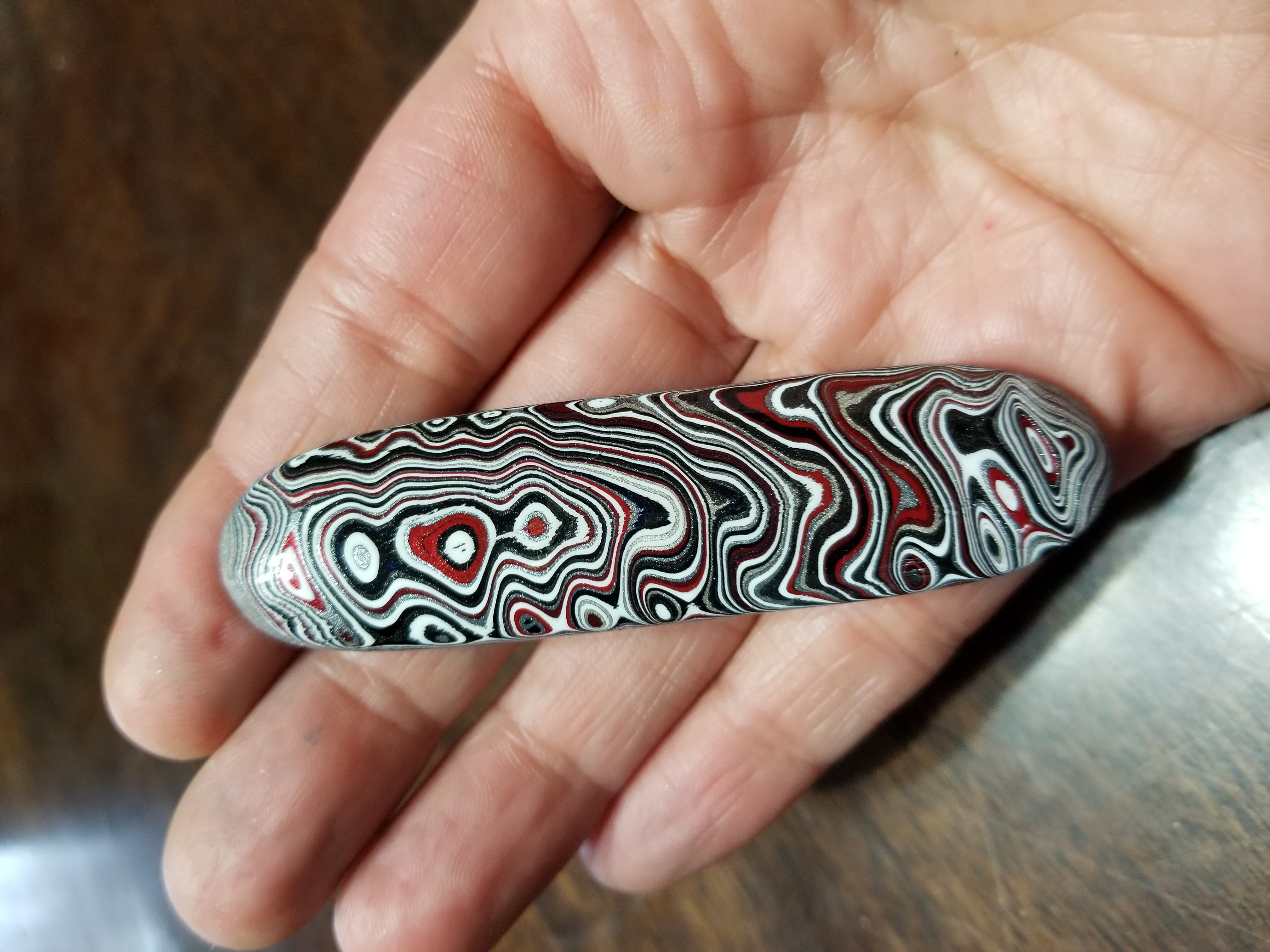

Post by romo on Jan 12, 2019 11:15:02 GMT -5
This was my first go with it. Both were cut from the same piece but as you can see in the second picture I really missed the mark on that second one.
Post by aDave on Jan 12, 2019 13:27:42 GMT -5
julieooly
Posts: 714
Post by julieooly on Jan 12, 2019 14:12:44 GMT -5
I have been working a bit of it lately and Tela is right, it is super soft and the patterns will change with each swipe of the wheels. Biggest challenge for me was getting the cab cut right to maximize the pattern you want to bring out. Sealing it when you are done is also an important step, I use a clear automotive top coat and apply 4-5 coats with a soft buff between each. Hope Chuck chimes in as his Fordite is gorgeous! I hadn’t considered a polish. This is through 3000 and I don’t want to put it up to the diamond paste polish disc until I know it won’t contaminate it. I have 14,000 and 50,000 discs. I’ll work harder toward keeping the center dot smaller. I need to cut it different to achieve more than one circle apparently? Or is this dictated by the condition of the material?
romo
Member since September 2018
Posts: 104
Post by romo on Jan 12, 2019 17:14:05 GMT -5
I have been working a bit of it lately and Tela is right, it is super soft and the patterns will change with each swipe of the wheels. Biggest challenge for me was getting the cab cut right to maximize the pattern you want to bring out. Sealing it when you are done is also an important step, I use a clear automotive top coat and apply 4-5 coats with a soft buff between each. Hope Chuck chimes in as his Fordite is gorgeous! I hadn’t considered a polish. This is through 3000 and I don’t want to put it up to the diamond paste polish disc until I know it won’t contaminate it. I have 14,000 and 50,000 discs. I’ll work harder toward keeping the center dot smaller. I need to cut it different to achieve more than one circle apparently? Or is this dictated by the condition of the material? Julie, I am a newbie to cabbing and am going off the advice of the members here as well as at my local rock club. I really am wanting to start working with chatoyant stones and was recommended to start cutting fordite to learn plane/angle/cutting skills. If you don't like the circles then rotate a few degrees and cut again! Some pattern is influenced by the area of track it is taken from and how much it dripped (or pooled) before drying. I am from Michigan and grew up in a car crazy family so yes, I top coat my pieces but I'm not actually sure if you have to? Or if polishing up higher is better? It is so soft I feel that the top coat seals and preserves it same as a car. I only take them through 1200, then clear coat.
