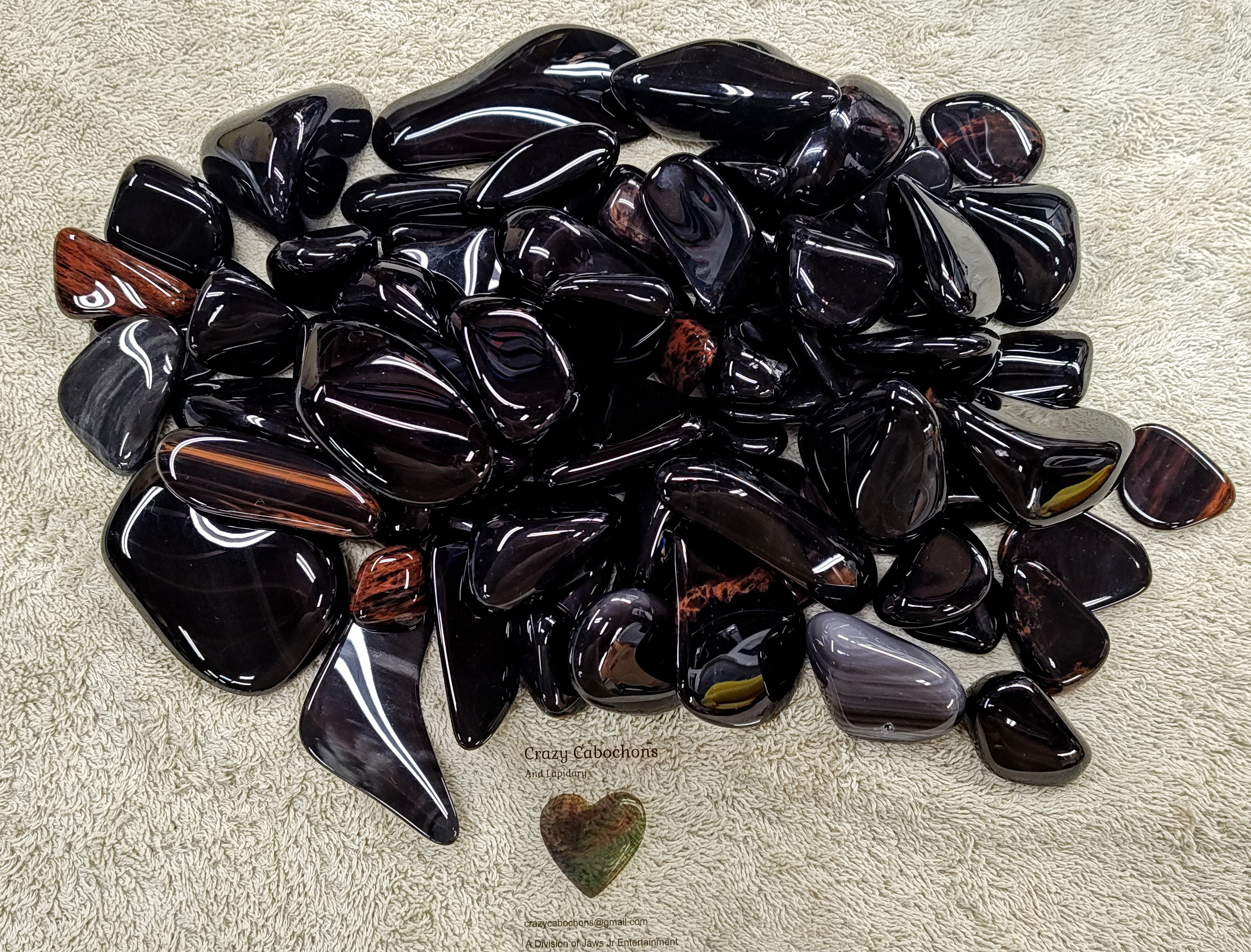

Post by hplcman on Nov 16, 2023 11:38:25 GMT -5
Here's a picture of that hunk I mentioned earlier. I think polished obsidian is absolutely beautiful, and I do hope you persevere with it!

Here's a picture of that hunk I mentioned earlier. I think polished obsidian is absolutely beautiful, and I do hope you persevere with it!  That shape looks really nice for obsidian, and that shine is to die for.
