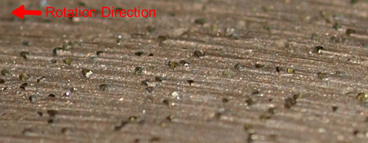

A sintered wheel that has been dressed properly will have lots of visible diamond particles with a ridge of bronze matrix, or tail, behind the diamond particles (see photo at the following post).
The bronze matrix ridge behind the diamond particle helps support the diamond particle and helps keep the particle bonded to the wheel surface. So in reversing the direction of the wheel then all of that bronze matrix would be on the lead cutting side of the diamond particles and shield most of the diamond from making contact with whatever you are attempting to grind .
So while it may be beneficial to reverse a plated wheel it is not beneficial to reverse a metal sintered wheel. If doing so you would have to remove so much material that you now have all newly exposed diamond particles with visible matrix tails running in the opposite direction from originally. Which is no more beneficial than having left it with the same rotational direction and dressed the wheel to the same state. Except when reversing the wheel you would just have to remove more material to get the surface to that same freshly dressed state.
