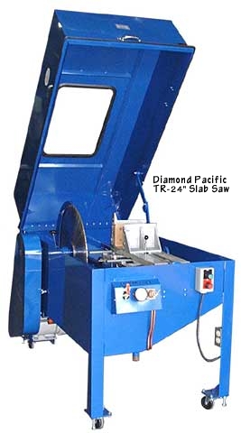

I bought an Iron Worker Built 20" Slab Saw.
Talk about HEAVY! He built the bottom, sides AND lid out of 1/4" sheet Iron!
Hard to believe, but my wife won't let me keep it in HER kitchen, Worra Worra, what to do?
Jeff's 18" build reminded me of some design items I like and dislike in my own (far from first owner) saw.
I like: the 1 1/2 hp motor, the gear reducer belt feed to easy change 3 speed feed drive, and the bearings outside the box.
I don't like: the hood being made of 1/4" sheet iron. The unit was already way too heavy.
The hood holding arm needs a notch so it can automatically drop into place when lifting the hood.
The vice mechanism was inserted too far away from the blade. Whoever put the angle iron on helped.
The box requires way too much oil.
The tension spring on the feed drive belt hooked directly to the leg, causing the belt and pulley to rub on the box.
The 1" drain was reduced to 3/4" 90 degree faucet. full of sludge and worthless.
The motor support rod is too hard to adjust.
The previous owner included a fan to keep the motor cool. -It was fed with a 20' 18 gauge lamp cord!
I re-wired with 12/3 SO cord and never had any over-heating problem!
