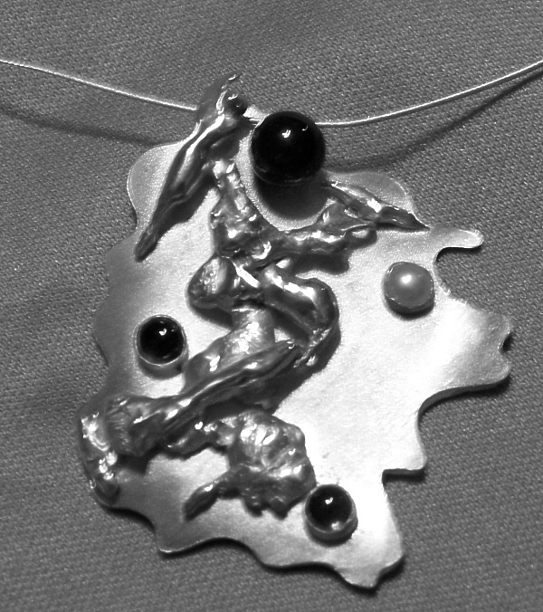

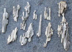

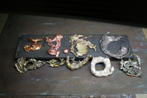

Casting Is well covered in Sharr Choate's book. Index: Partial Melt, Water etc. Casting, Carving Cuttlefish etc. - Here. Centrifuge Casting Sand Casting Sandcasting the JB WaySling Casting Steam Casting Vacuum Casting Buying Gold & SilverGold, Silver, Brass, Bronze, lead, solder, make it easy on yourself! You can make some fantastic pieces very simply. I suggest you start with aluminum or brass because it is easy and inexpensive. When you are sure of yourself then move up to the expensive stuff. 1. Arrange scraps of metal in an interesting pattern, heat until it just begins to melt together, and STOP!  Those partial melts may be just the thing to use in fabricating a splendid piece of jewelry! Continue heating with various sized pieces of scrap and they will turn into spheres, again Stop. Those spheres can be used in so many designs. Or continue heating and the spheres will flatten out. If on a carved mold, the metal can be hand pressed - uh, use a fire brick or wet piece of wood, not your hand - into the mold. 2. Or continue to melt your metal, then pour it into a pail of cold water. The drops will form amazing shapes.  That can then be used in fabrication.  Dripping melted silver into water, ice, wet pine needles pine cones, or broom straws provide interesting shapes to work with! I always used a wet whisk broom. It still seems like a better idea.  3. mold casting - Using an old board can be a good beginning. Carve a form first, char it, refine it, melt your metal on it, then use another (wet) board to mash the hot metal flat. Try making belt buckles this way! Cuttlefish casting -  4. Vacuum Casting - Don't toss that empty propane tank!  Open the valve all the way and heat that tank to drive all the gas out. Do it several times, then close the valve while still HOT! When it cools down, you will be the proud owner of a vacuum casting unit! Make your mold with a hole in the bottom the nozzle will fit in, Burn out the wax, melt metal on top of the mold, then stick the nozzle in place and open the valve. The vacuum will help suck the molten metal down into the mold. 5. Sand Casting - 6. Sling Casting - I would never try this with gold. 7. Steam Casting - steamcast.blogspot.com/8. For Lost Wax Casting you will need a centrifuge and metal wash tub to keep gold from flying everywhere!  I make my forms out of copper pipe to fill with cristobalite and my wax mold, but you will need to purchase Crucibles to melt your metal in:

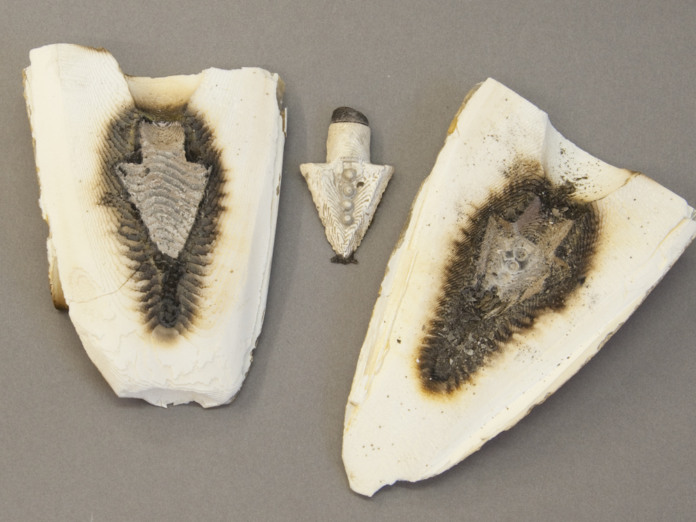

Sounds like a twist on traditional Navajo tufa casting. I recall reading ads for this long ago in LJ but could never quite understand what made it "different." Maybe you can explain? Rick Tufa = limestone, travertine; but Eric Begay wrote: So it sounds to me more like pumice. Navajo artists took two chunks and rubbed them together until both pieces fit well together, then carved a pattern into both pieces with an opening at the top, heated the cavity, then poured molten silver into it. ebegay.com/mm5/merchant.mvc?Screen=TUFAMaking do with what you had instead of buying $50,000 worth of equipment must have been a plus. I think it would be a great way to make a belt buckle or bracelet.

Tufa = limestone, travertine; but Eric Begay wrote: So it sounds to me more like pumice. I believe the word "tufa" in common use for that casting technique is a misnomer. The porous volcanic stone used by the Navajos is probably tuff, compressed volcanic ash, not limestone. I cast some silver pieces using that method years ago and -- if I recall correctly -- the material was tuff which is basically tiny shards of wind-borne volcanic glass that's been solidified as sediment. My original question was how does the garnet technique differ from tufa casting? What does the garnet sand do? How does it improve the process? Rick [/quote]

Tufa = limestone, travertine; but Eric Begay wrote: So it sounds to me more like pumice. I believe the word "tufa" in common use for that casting technique is a misnomer. The porous volcanic stone used by the Navajos is probably tuff, compressed volcanic ash, not limestone. I cast some silver pieces using that method years ago and -- if I recall correctly -- the material was tuff which is basically tiny shards of wind-borne volcanic glass that's been solidified as sediment. My original question was how does the garnet technique differ from tufa casting? What does the garnet sand do? How does it improve the process? Rick Ah, I thought you were asking about the Tufa. I'm sure you are right about Tuff! The garnet has a reducing effect like working on charcoal so there isn't so much of a fire scale problem. Dave [/quote]

A little side note on tufa casting, always make sure your mold is dried out or you will have an experience similar to Mount Etna! Put in the oven at 150F for an hour to drive off all ambient moisture that will have collected in the stone, it is somewhat porous and does tend to absorb moisture. Be safe, molten silver leave some nasty scars.

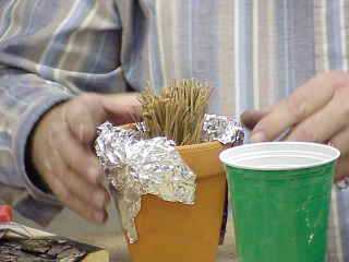

Has anyone posted about steam casting? I seem to recall a discussion about it somewhere but I can't find it here. It's a cheap method of learning precious metals casting and good results can be obtained with it. I cast this gold ring with steam:  My equipment consisted of a short piece of broom handle, a big jar lid, wet newspaper, a terra-cotta flower pot, aluminum foil, modeling clay, an old electric hotplate, a sturdy tin can, some specially-shaped wax sprues, a commercial wax pattern, casting investment powder and of course the metal and a torch to melt it with. Here's a great, detailed tutorial by Don Norris: www.myheap.com/chapter-10-steam-casting/steam-casting-lessons.html?showall=1

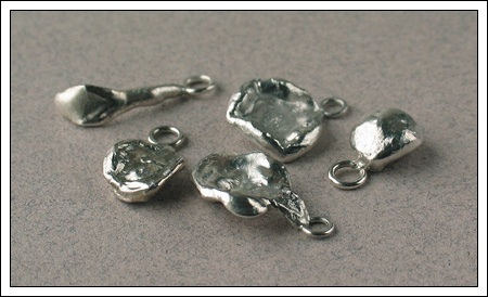

Thanks Rick! Steam Casting - an easy start for beginners!  As water turns to steam it can expand up to 2,000 times it's original volume, easily producing enough pressure to force the metal down into your mold.
