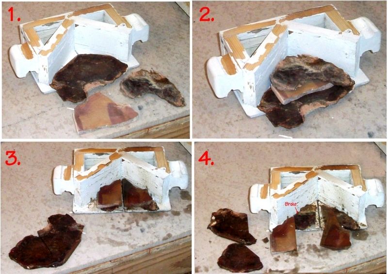

Post by 1dave on Jul 28, 2015 14:53:25 GMT -5
jamesp wondered if this would work with slabs. I tried them three at a time. A 1/2 day rock trip in Utah ? Unthinkable. We already have more rocks than we will ever do anything with. Getting out is the BIG DEAL! We went to "Gee" will post in Trips when I get back from town. I grabbed three slabs so it had to hold all of them secure and tossed them in my jig just for you. I forgot it couldn't cut beyond 3 1/4" and when it hit the end of the table, had to stop and take it out. I put the top slab back in first, then finished cutting. It broke on a fracture, but the cut continued as if it hadn't happened. The jig is a winner with slabs.

Post by jamesp on Jul 28, 2015 18:42:44 GMT -5
Looks like they could have been stacked 2 inches deep. Great carpentry, not so great a painter. I see you guys using our southern pine. Don't you have your own fir trees ? Perhaps a tariff needs to be put in place. Those trees grow on Confederate soil.
