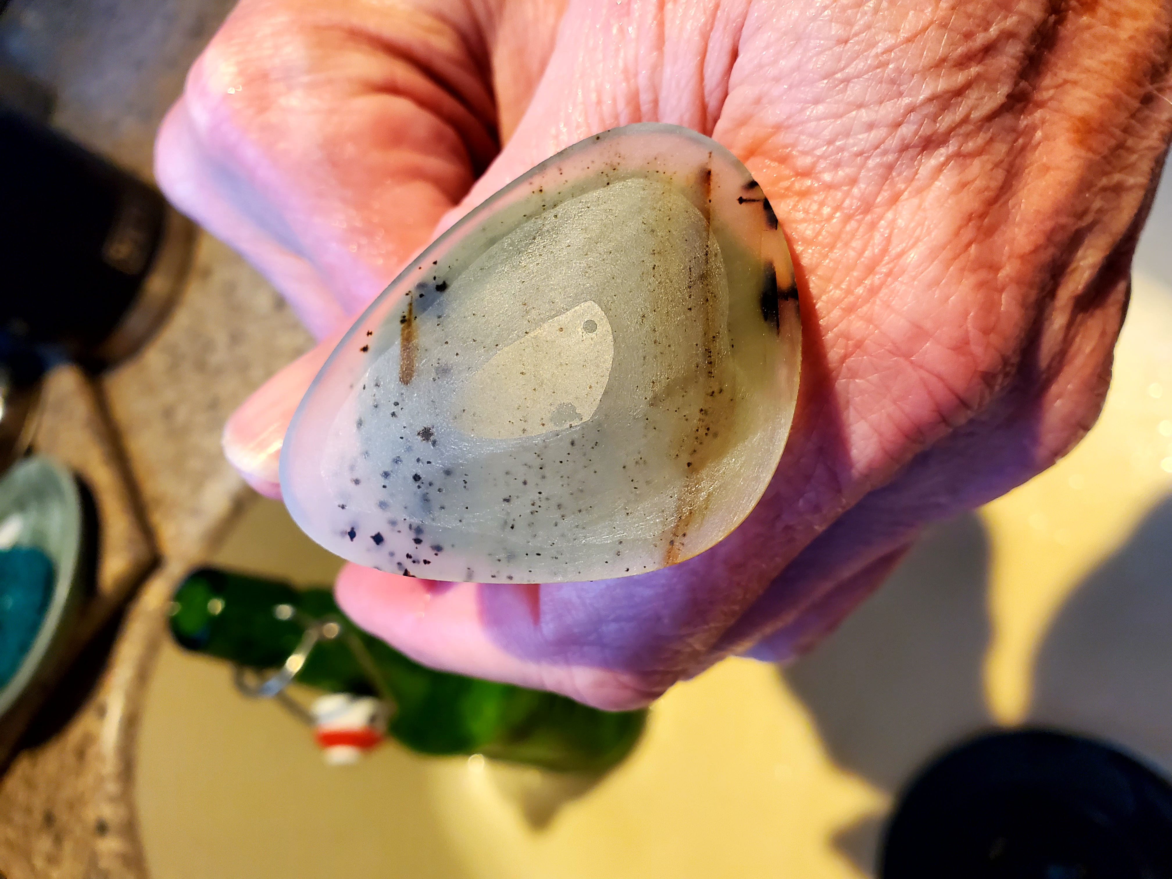

Here is a preform with the first bevel. On large cabs like this I do 3 bevels (80 grit). I will do three bevels at increasingly flat angles. Two bevels on smaller cabs. I try to leave the flat spot in the same shape as the preform on each bevel. Once the bevels are done, I start rocking the cab back and forth on the wheel. This is one of my keys to flatter domes. It takes a while but it ends up with a pretty uniform dome. Stock removal on any lapidary project is the hardest part. My daughter helped me with the photo. You can actually see the flat spot on top of the cab. When I tried to take a similar photo, the flat spot wasn’t very visible.

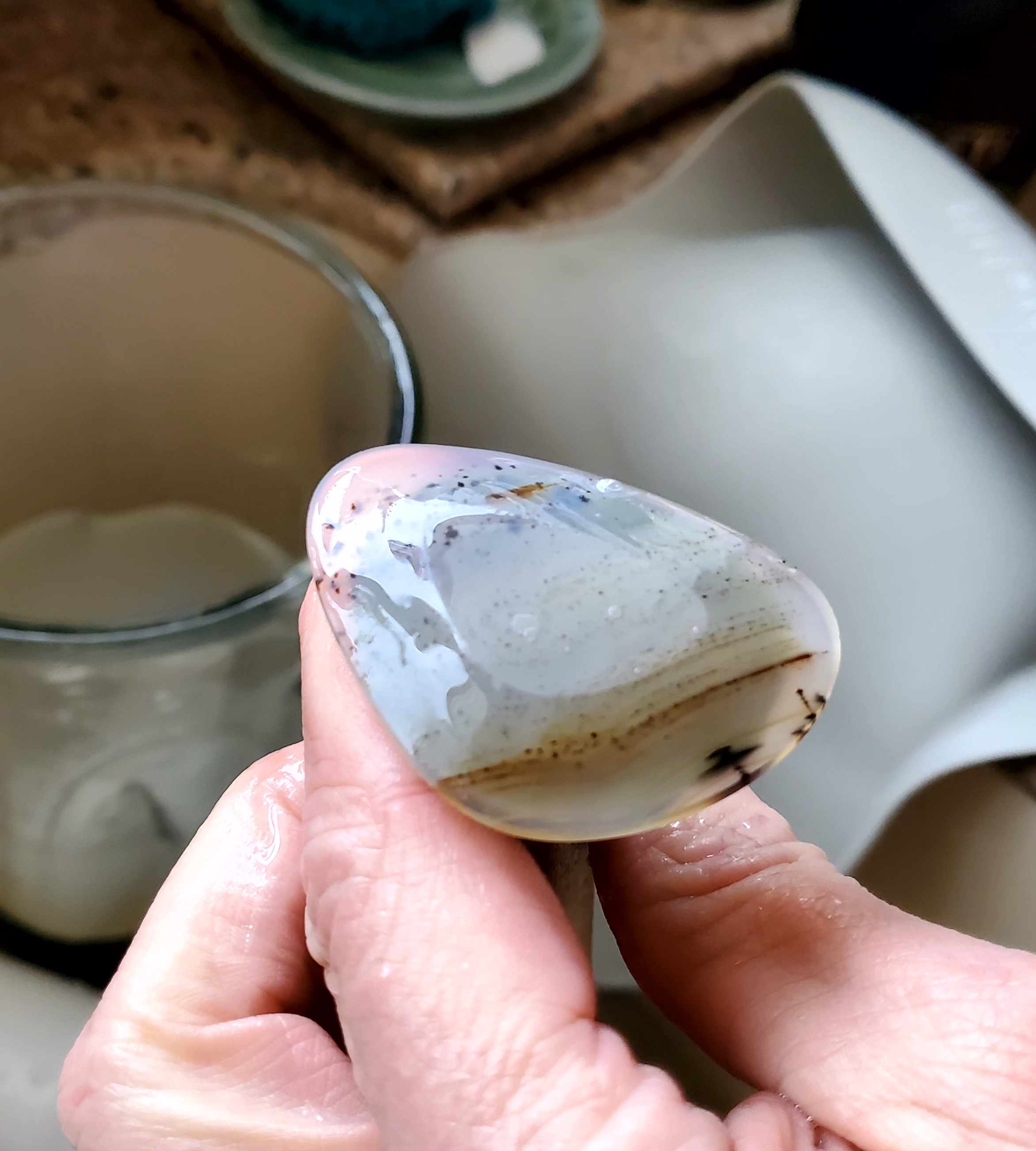

Here’s bevel two. The flat spot is still similar in shape to the preform.

Thanks perkins17 . I’m not a finesse cabber. I tend to do a lot of big cabs that are nearly useless for jewelry. I want to get a groove cutter so I can groove wrap some of the thicker cabs. I think you need to cut the groove before cabbing though. I’ll try to get some photos of the cab when it’s done. It’s a crack free Montana moss agate.
