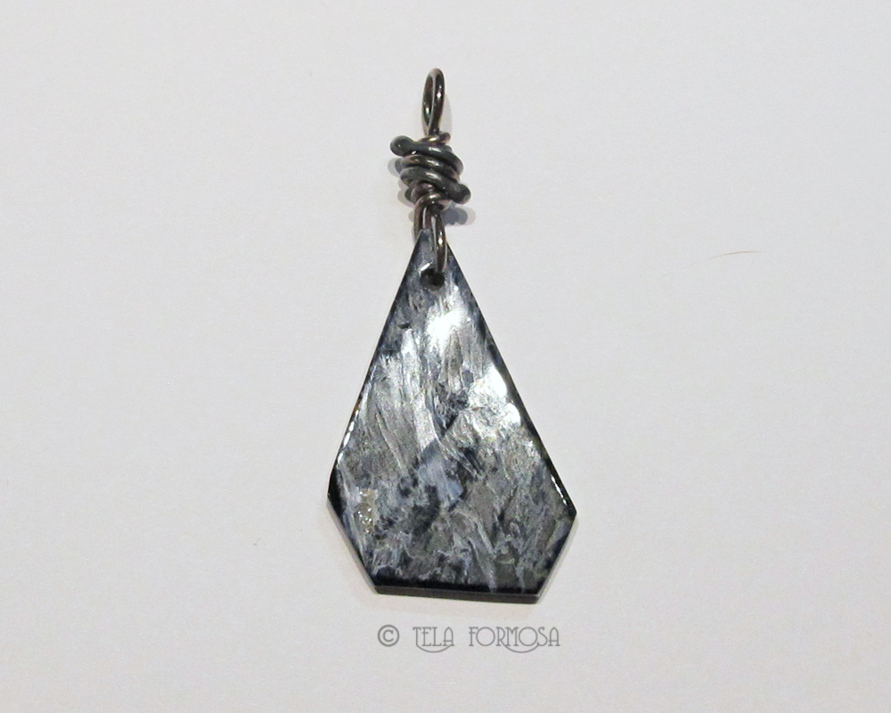

Just finished this and took some pics along the way for instagram. I got the pietersite from Jeff Barnhouse and it is SWEET! Best I have ever seen. The slab wasn't cheap even though it is very thin. I knew it was thin and I was cool with it, but Jeff messaged me to make sure I knew before he sent which I thought was really stand up. So, I got the slab because it is so great and thought I would make doublets, but then I was like.... why not tumble it? And I did. Came out fantastic! I tumbled 2 days in 500 and 2 days in AO polish.
This is it finished- I ordered a nice chain for it. Stone is 40mm
step one, get the bail on with plenty of room for the tip of the stone. I used 16g argentium

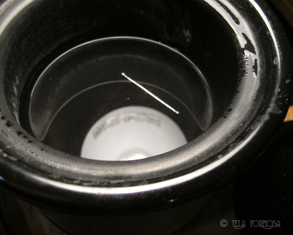

I balled up the both ends of another piece of 16g and dropped it in the pickle
I wrapped the balled wire around the bail. And then it was patina time. It took better than usual for argetium

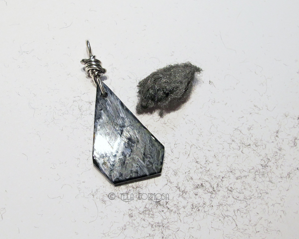

Ick... I still use good old fashioned steel wool to take off the excess and follow it with a brass brush then pink spiders. (3m radial bristle sanders)
after all that, this is what it looks like.

To ball up the ends of the second wire did you use a torch and melt them? The addition of that second wire wrapped almost perpendicular to the bail adds a really pleasant discord to the piece.

To ball up the ends of the second wire did you use a torch and melt them? The addition of that second wire wrapped almost perpendicular to the bail adds a really pleasant discord to the piece. Yes, just a kitchen torch. Butane.

To ball up the ends of the second wire did you use a torch and melt them? The addition of that second wire wrapped almost perpendicular to the bail adds a really pleasant discord to the piece. I meant to mention that I was using Argentium sterling silver which doesn't need a flux to make a nice ball without dimples the way regular sterling does. That was 16g wire and a small creme brulee torch worked fine.
