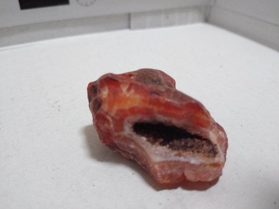

Post by sheriam on Feb 17, 2020 12:47:36 GMT -5

Post by sheriam on Feb 17, 2020 12:49:44 GMT -5

Posts: 34
Post by sheriam on Feb 17, 2020 12:51:12 GMT -5
What about cracked open agates like this one, can they be tumbled
