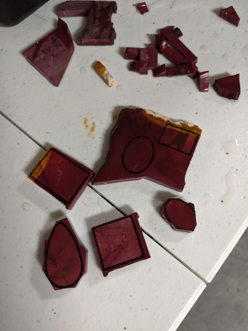

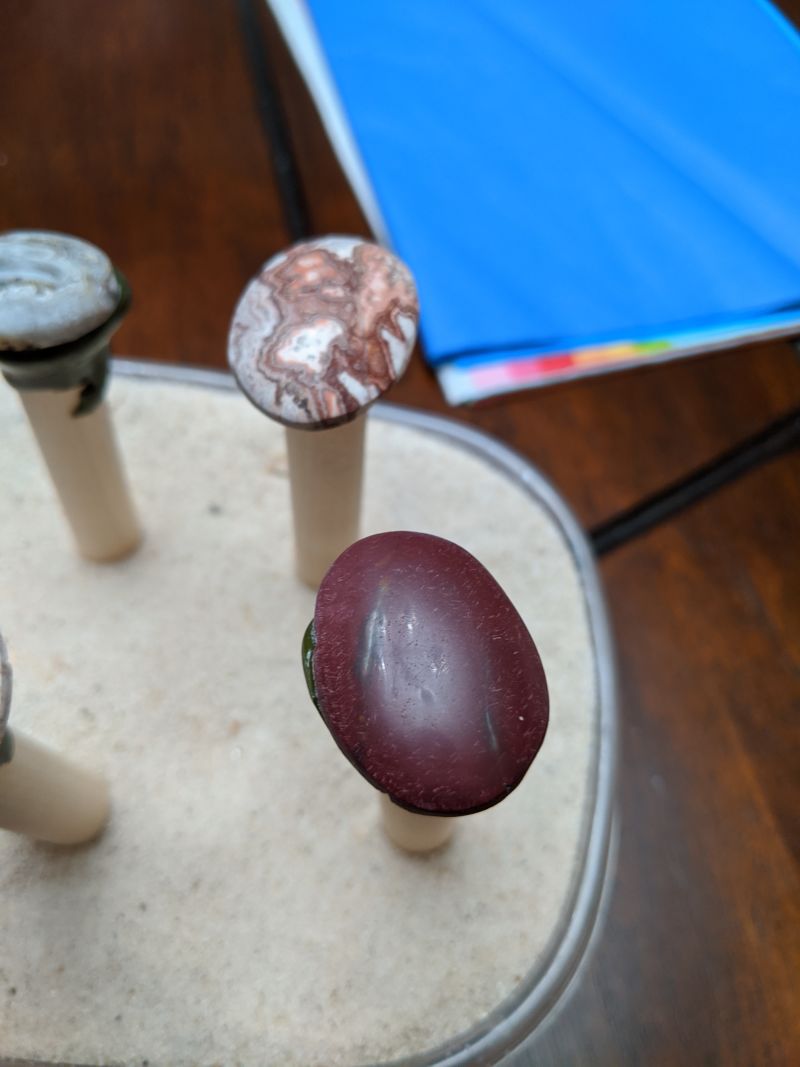

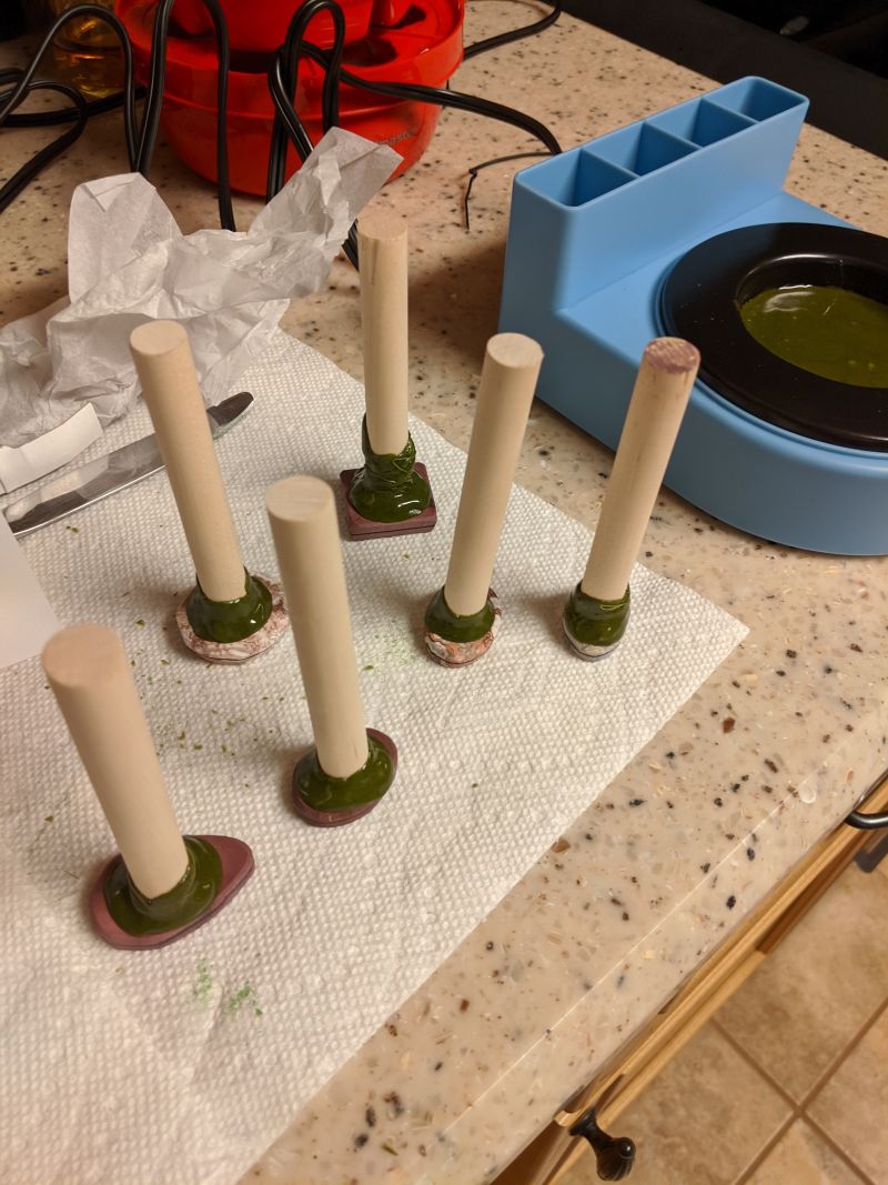

Here are my first attempts at making cabochons! I started with a cheap grab bag of slabs that I purchased, and stenciled in some shapes. I think this one is jasper? After roughing out the shapes for this and a few other slabs: And after dopping: I smoothed out the edges with my flat lap on the coarse wheel (180 grit) and ground out the first angles to make the dome shape. I used the same wheel to then smooth over the angles to create the dome. Then, I switched to the next wheel (brown, 325 grit) and tried smoothing a few of the stones. It's working, but it's going very slowly. Take a look at this one: I've been at that one on the brown wheel for probably a half hour at least, and there are a lot of stubborn scratches that just don't want to go away. Is this how long it should take? I heard that experts can take a full stone from rough to finished in 30 minutes, so spending that much time on just one stage doesn't seem right. Any advice is appreciated!
Post by MsAli on Feb 16, 2020 8:26:39 GMT -5
When you are first starting out, it may take longer, especially depending on the stone.
What machine are you using?
You may have to go back to the 180 and then try the 325 again
Watch your pressure. Let the wheel do the work -that was a hard one for me to learn
and lastly really watch running a stones top across that 180, some dont like it much and the scratches will be harder to work out

That first stone looks like it could be mookaite. If it is, it's pretty hard stuff. MsAli gave you some good advice. Let the diamond do the work. Go back to the 180 and gently go back over the whole cab until all the deep gouges are gone. Then move on to the 325. It does take longer to use the flat lap to cab than wheels, but it is still a great machine and I use mine still. I bought it a long time ago (20 years?) when I started cutting opal and it's still going strong.
Another alternative is to buy a 220 diamond disc and another base lap and use that as an in-between grit.

Cabbing on wheels is definitely easier than it is on a flat lap. I started with a cheap flat lap, and was amazed by the difference when I got a used Genie. New laps or wheels are also more aggressive than they will be after they're broken in. It's good to cut a few cabs of consistently harder agate to break them in.
The closeup of the oval cab has some low or "flat" spots. That fits with what Ali said about dropping back to the 180. Holding a cab in hand and looking away while you rub your thumb lightly over the surface will often help you find flat spots that aren't obvious to the eye.
The rough that cab came from looks like it has little lighter colored spots in it. If that's the case, they might be softer than the surrounding material and might or might not ever polish up the same as the rest of it. That's a really common (and annoying) fact of lapiday life. Mixed hardnesses in a stone are a royal pain.
I see you're using fairly large dop sticks. Depending on your hand size you might want to try other sizes. I use smaller ones unless the cab is really large. That's all just personal preference, and you'll get a feel for what you like best in no time.

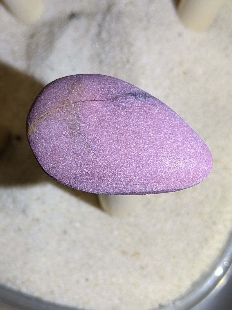

I tried working a few more crazy lace agate pieces that I had, to help break in the 180 wheel. I then went over one of my other red stone cabs, and I'm still seeing a lot of those deep scratches. I mean, that's definitely caused by the wheel. Does that not polish out at the next step? I don't see how I can shape a stone without causing deep scratches. I must be missing something. For reference, here's the stone from before under the same lighting. I do also have a big Brazilian agate I can slab and cut up, if you think the wheel being new is the problem.

Those scratches will decrease as the 180 is broken in more. I hate breaking in new wheels.
Like Robin said, adding a 220 grit to the sequence would help a lot.

I always went from 180 grit to 220, but I think MsAli was correct, you need to use a lighter hand on the 180 wheel, especially once you have it close to the desired shape. It's a common mistake that most of us probably did when we started cabbing. One more thing to check, are you using enough water? Make sure you are. As knave said, Try drying the stone occasionally while working, and you can see scratched areas you need to polish on.
Post by hummingbirdstones on Feb 18, 2020 8:49:27 GMT -5
You can buy a 220 disc and a separate backer plate to put it on.
A little bit cheaper and they'll last a long time. I still have all my original backer plates. I just have to replace the smoothing discs every once in a while. It takes a really long time to wear those suckers out.
Post by MsAli on Feb 18, 2020 9:10:33 GMT -5
Adding the 220 helped ALOT! Highly recommend it
