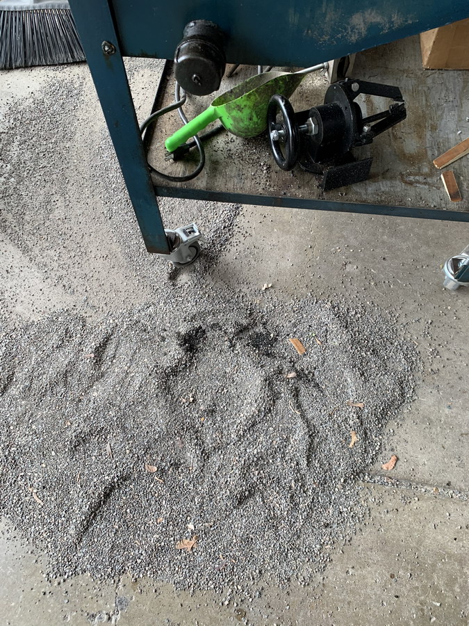

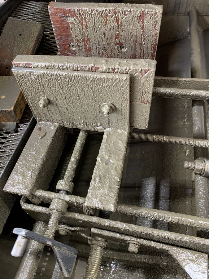

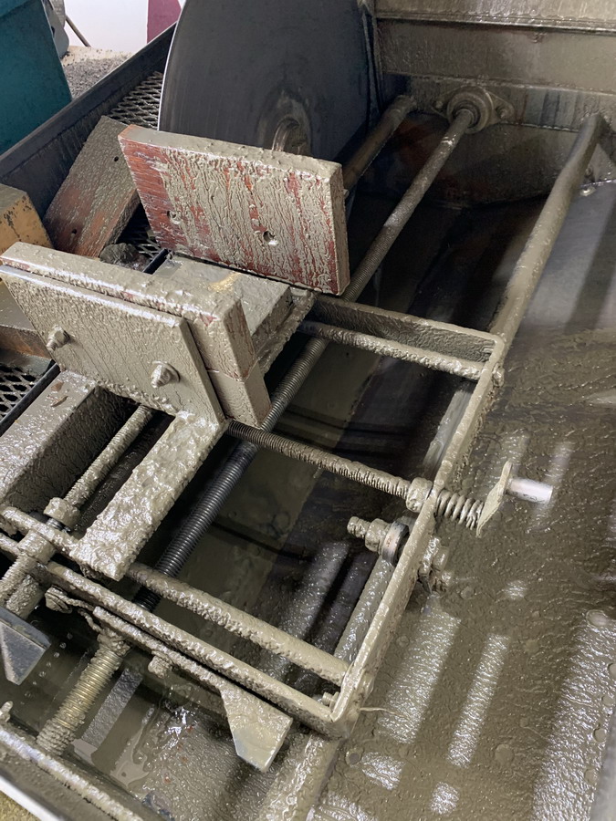

Well we will call it lunch hour. Working from home for the next few weeks and decided to clean out the new to me 18" saw for the first time today. When I got the saw it already had oil in it but I did not realize under that oil was a pretty solid 1" to 1 1/2" thick layer of muck. Pretty messy job scraping all of that out. Hopefully if I do more regular clean outs they wont be as bad. I was originally thinking I would install a 90 and a valve for easier clean outs but now I realize the straight pipe makes it much easier to clear jams of rock debris and muck. The old oil is in the transfer bucket now to be filtered but with temps still getting down to the 30'S here the oil will take a long time drip through. I never clean saws spotless. Just a quick rinse of the vise, rails and feed screw. First few cuts and it will be a mess again anyway. I have learned from other saws to always dump oil-dri down before I start a clean out. Better safe then sorry. Chuck

Post by Drummond Island Rocks on Mar 19, 2020 10:07:55 GMT -5
Thanks. My general rule of thumb is to clean the vise, rails and feed screw. A cheap nylon brush works pretty good. I just dump some clean mineral oil into an open container and then keep dipping the brush into that when scrubbing. Chuck
