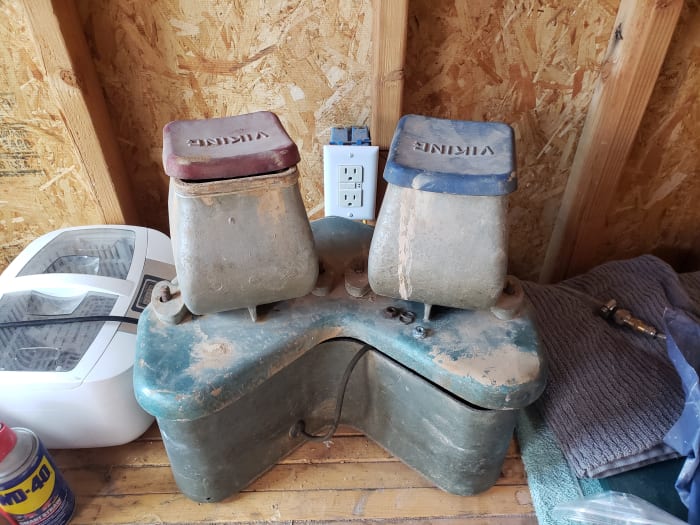

I just re-discovered a vt-12 dual hopper vibratory tumbler in the back of my garage, and it is very old and musty. I cannot get it to work though, I think it is a problem with the motor. When I plugged it in and flipped the switch, there was a faint buzzing and it started smoking. I turned it off and have not touched it since. Any tips on what to do?

flip it over, see if the belts are intact, see if the motor turns easily by hand. or just ship it to me

Post by leviathan21 on May 21, 2020 13:36:18 GMT -5
The Belts are intact, And it does not turn almost at all.

Break out the oil and hope you turned it off fast enough when it smoked. Try and get the motor to turn freely with the belts off.
Post by oregon on May 21, 2020 15:34:43 GMT -5
The Belts are intact, And it does not turn almost at all. doesn't bode well, remove the belts to make sure it's not the countershaft bearings that are seized. Otherwise I'd disassemble the motor to free it up, there are/were greased bearings in there.
