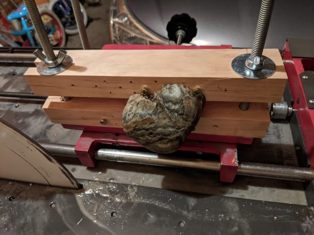

Post by agatewhisperer on Aug 6, 2020 21:56:30 GMT -5
I'm glad you asked this. I'm also pretty new to it and here's a picture of what I've been using. Works ok but need to be careful to get it parallel especially after the rock is tightened down.
