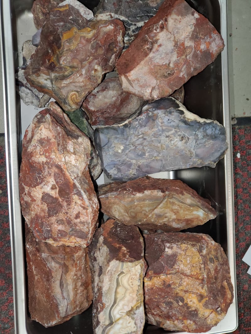

I have some large chunks of Mexican agates that I ultimately want to use for cabs, while tumbling the scraps. The metal pan is 22" x 13", to give you an idea of scale. The larger chunks are 6-7 pounds each. Here is my question: I will need to use my 14" blade to make initial cuts on these, which gives me a 5-1/2" depth of cut. That blade (a MK hot dog tile blade) is 0.08" thick, so if I cut 0.25" slabs, I lose about 32% of the rough from the cuts (4 cuts creating 4 - 1/4" slabs would result in 0.32" of cutting loss). On a slower, smaller saw with an inferior vise, I can use a 10" MK-303 blade which is .032" thick, but only gives me somewhere between 3" and 3.25" depth of cut, and it won't handle extremely long pieces, regardless of thickness. Should I use my big saw to cut these chunks of agate into thirds or fourths and then slab those smaller chunks with the small saw? The alternative would be to just slab them up on the larger saw and lose about 32% of the rough in the process. The 10" blade only eats up about 13% of the rough, and the two blade approach might result in an overall cutting loss of around 18-19%, instead of 32%. Any opinions on how I should proceed? My time is valuable and somewhat limited, but thees agates weren't exactly free either...

That is some nice looking rough holajonathan I would think the bigger saw would give some nice slabs. You could use the smaller saw to slab what is left over. I have a lot of pieces that are now too small to clamp in my 16” Covington.

Chop em in half With the big saw. If you like what you see? Slice the remainder at slow speed On the 10”
If not? Sell em’ and start over😊

I'm glad I'm not the only one who was considering the loss of material when cutting. I like your "combination" approach and it is likely the way I would go if I had the two saws available. I also like @hookedonrocks approach to the whole matter. The rough would definitely sell...and even if you take a small loss (financial - not material) on it, just consider it a "rental fee" you had to pay to check them out.

Chop em in half With the big saw. If you like what you see? Slice the remainder at slow speed On the 10” If not? Sell em’ and start over😊 Good call. It looks like good material and comes from a supplier who has always sold me good material, but no one knows for certain what is hiding inside. As you mention, speed is definitely part of the equation. My big saw is a MK tile saw with a 1-1/2" hp Baldor motor. In my testing of the saw so far, it rips through the agate, but spins too fast to use a thin lapidary blade, and doesn't leave quite a smooth of a cut as a slow, thin lapidary blade. But it literally cuts about 5X faster than a true lapidary slab saw and does a respectable job at it. Slabbing with my 10" mini-slab saw is a slow process. I think it advanced 3/16" a minute, so I could keep it running all day on one of these chunks. The payoff for patience is very smooth and precise cuts with minimal blade wear. The 14" MK hotdog blade I just installed on my big saw shows no wear after a few cuts, but the way it rips I can't imagine the blade is going to last very long.

Halojonathan, I think the more important question is orienting the first cut so that it might give the best chance for a window that shows great designs and not worry about saw kerf loss. Sometimes a face cut is used to mount the remaining portion to a mounting block.
Post by stardiamond on Jan 12, 2021 23:49:07 GMT -5
Big rocks big saw, small rocks small saw. Big rocks means a lot of material and when planning to make cabs, I don't worry about waste. Small rocks less material and a smaller kerf for less waste. I can cut small rocks on my bigger saw because I cut off boards but lose more material. I just bought a 10 inch saw to go with my 16.

holajonathan I like the question you are asking because is shows an analytical mind trying to maximize the rough you have and figure the best way to proceed. This is exactly what the RTH is for and many on here have done the same before one way or another. From my point of view: Lets say the average "rock in the box" above cost you $6.00/lb and there are 45 pounds. Your total cost for the pile of rocks is 45lb*$6/lb=>$270. If you waste 32% in the saw kerf, then when you get done you will have 45lb-14.4lb=> 30.6lb of slabs. If we take the loss at $6/lb*14.4lb=> $86 is the cost of lost rock. If the other method results in 18% loss the 45lb*.18=> 8.1lbs of lost rock. That means the difference between the methods is 14.4lb - 8.1lb => 6.3lb*$6/lb=>$37.80 in incremental loss. What is missing is how long will it take you to slab the 45lb of rock with the big saw and how long will it take to slab with the small saw. If it is 1 hr then you have saved $37.80 in an hour and you can say I am worth $37.8/hour. If on the other hand it will take 4 more hours then that number is down to more like $9+ per hour. So what is your time worth?

Generally I would rather cut rocks on my 10 inch saw rather than the 20" or 24". The issue becomes rock size limit on the 10 inch which moves a good many rocks to the larger saws. Many times when cutting a larger rock on the big saw, if shape permits I will cut off the end 2 to 3 inches if that piece can be cut on the 10 inch. Two reasons for me, biggest reason is saw cleaning. I can clean the 10 inch in about 15 to 20 minutes. The 24" can be the better part of a day and then there's the 15 gallons of oily sludge to deal with. That's a no-brainer for me. The second reason is the cost of the blades. 10 inch blades are a whole lot cheaper than a 24" blade. The more I use the 24 the quicker I get to needing a replacement blade.
One thing I never worry about is how much material is wasted by the cut. I am in a good position in that I have an over-abundance of cutting material, most of which is either self collected or purchased at discount. Wasting a few extra pounds here and there doesn't seem important. Usually desired cutting plane and clamping dynamics trump wastage every time for me.

The issue of waste is more important when selling slabs to maximize the yield. I only slab to make cabs and estimate the yield taking waste into account. I also am willing to leave a few slices on the board that can be cut at a later date.

I like the above advice to zip them in half or cut a window to see what you are dealing with and then make a decision on individual rocks. I predict the one on the top left is the nicest inside. Waste is unavoidable when rocks are cut, but in my opinion the quality of the resulting slice(s) is the most important.
