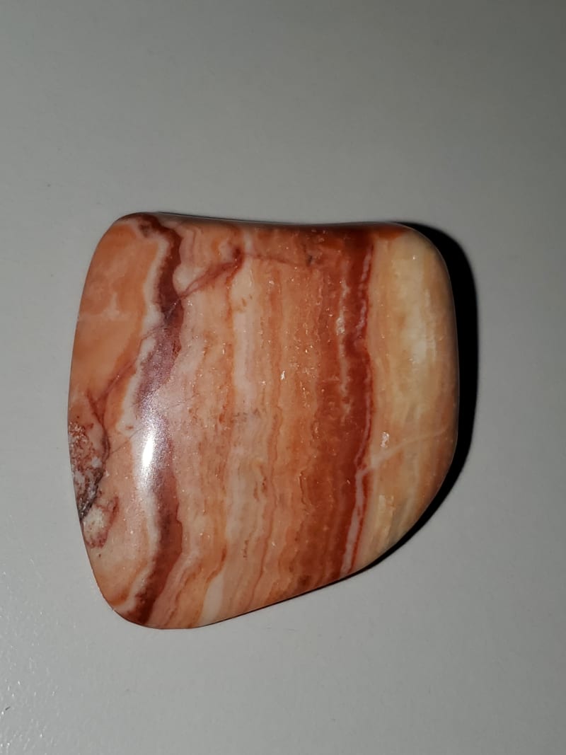

This stuff is sort of pretty, but best I can tell it contains neither strawberries nor onyx. (Almost nothing sold as "onyx" is onyx, a mohs 7 rock that takes a splendid polish.) Worse yet, I cannot get it past a matte shine in a tumbler or using wheels. I figured the cabbers are experts on whether a rock will take a good shine and how to do so. Anyone have any advice on how to coax a shine out of this fruity rock? Got photos to prove it? I tried to polish this test piece using wheels (up through 14,000 on the Genie) and then on rawhide with 0.3 micron AO polish. It did not shine. I put it in the Lot-O tumbler with a bunch of ceramics, a few other rocks, and 0.3 micron AO polish. After two days, the surface has sort of a shiny crystalline appearance, kind of like some feldspar. But it is about as shiny as an agate after the 1200 grit wheel on the Genie. Is that as tasty as it gets for this desert berry? What is this stuff anyways, dolomite?

We all know I'm not an expert...but this came from Paul ( fencejumper) when I asked him about Noreena. He said to go dry on the 1200 and 5000 grits. He said it works on Cherry Creek and Rhyolite...

We all know I'm not an expert...but this came from Paul ( fencejumper) when I asked him about Noreena. He said to go dry on the 1200 and 5000 grits. He said it works on Cherry Creek and Rhyolite... I would try shellac

Yeah, that's actually a travertine which is calcite hardness. It should polish well on tacky leather with optical grade cerium. Just enough pressure to drag against the pad but be careful of holding it too long as too much heat from friction will often fracture travertine.

I always polish my 'Onyx' with a dry buffing wheel and some Zamm, works great for softer rocks. Just use in a well ventilated area, I hear it can be bad for your lungs.

"onyx" as in not real onyx but the trade name onyx as in Mexican Onyx, Petoskey stone, Travertine, Onyx from Pakistan, and dolomites all have CaCo3 or CaMg(CO3)2 as the main component. Other impurities will affect the polish. for hand polishing cerium or tin oxides with a bit of Oxalic acid helps polish.

The whole “onyx” thing is a pet peeve of mine. I get pretty decent results using worn wheel, letting it get hot, but not as hot as obsidian or jade, using either super cerium or 100k diamond. I haven’t worked with strawberry varsity, but it works well enough on silver lace and rainbow varieties. Also, been successful with the “cousins” already mentioned as well as rhodochrosite, marble and abalone shell. I haven’t tried the oxalic acid trick.
