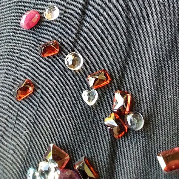

Hi Perhaps some someone could supply some info on the faceting technique ? Know that you can’t i.d. the stones From this very lousy photo All I got was quick late night view of these finely faceted pieces They are so tiny and the viewing situation was less that optimal To give a fair appraisal  Anyway what I’m really seeking The skill of faceting On such minute pieces Is incredible ! Any insights ? Thanks for the help Ed

Not quite sure what you're asking. There are 3 basic types of faceting set-ups to my knowledge: jamb-peg, handpiece and fixed-arm. Many tiny stones are cut in low-wage countries by the traditional jamb-peg method: a board with holes cut at different angles and a long dop that can be inserted into those holes selectively to achieve the desired cutting angle.
The handpiece method involves a loose handpiece with dop attached that sits on a flat surface. The handpiece is often called a "frog" and the surface it sits on a "lily pad." The frog can be adjusted for the desired rotational angle and height is achieved in different ways. My machine's lily pad can be raised or lowered to achieve the desired lap anvgle as needed. A sophisticated version of this method is used in traditional diamond-cutting.
Finally the fixed-arm machine. This machine incorporates a dop arm and angle ajustment in a single unit, including the lap. This is the most popular style of machine in the U.S.
I have seen many extremely tiny faceted gems cut essentially "by eye" using the jamb-peg method and with handpiece machines, which are very widely used in Asia. There was something of a scandal some years back because diamond cutting firms in India that specialize in tiny 1 to 5 point stones (one hundredth to 5 hundredths of a carat) use young sharp-eyed children for the task. Essentially, experience, skill and sharp eyesight are required for cutting the teeny-tinies. Many American amateur cutters refuse to cut anything smaller than 1 carat.

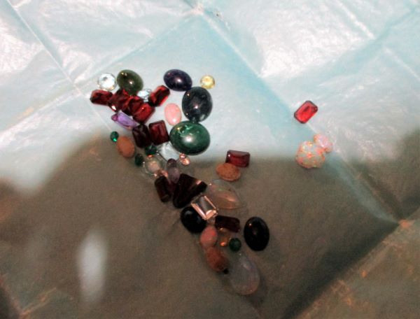

Hi Rick gemfeller Excellent response You answered exactly what I was wanted to know ! Actually you were the first person who came to mind So I appreciate it I’m hoping to get a better picture and appraisal of these stones What I think was jade & the opal looked authentically natural Not sure what the red stone or others -if there just glass? Hard to imagine a highly skilled sharp eyed young’n being able to Lap a natural hard stone such as a ruby that tiny So I assume they are glass Anyway hoping to get a better picture And even getting the chance to appraise them in person. Thanks again Rick Good Luck getting through another Arizona summer As always Ed M  stly

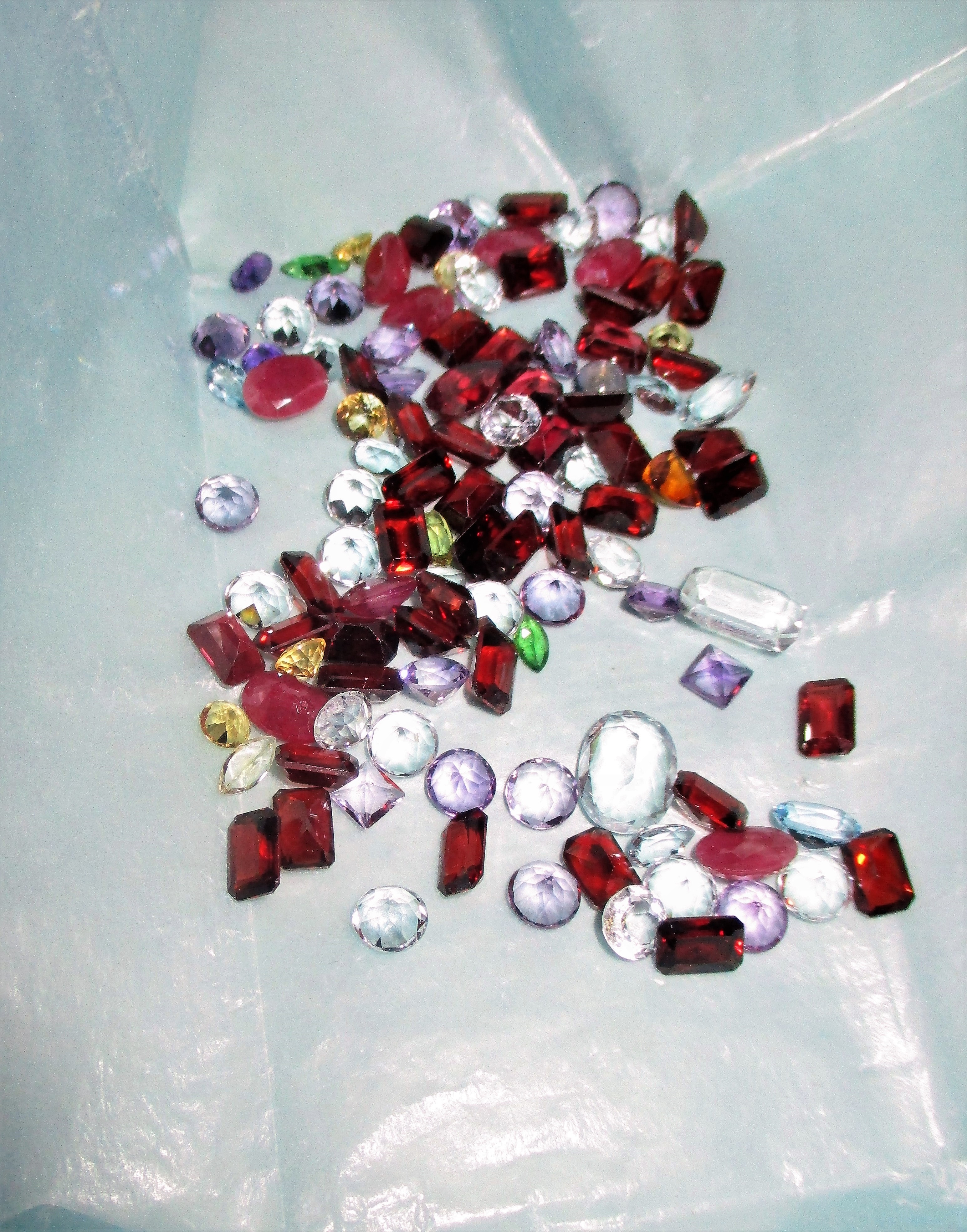

Small/tiny stones are easy, they are quick and the tiny facets are easy to get a quick polish on. As long as your eyes are good. What you said about Rubies is not right, being hard makes them easy, soft stones are the difficult ones.
Post by mohs on Jun 12, 2022 18:27:23 GMT -5
Actually that makes a lot sense to me About faceting is somewhat easier harder the material so an inspection under the loupe may tell the tale of the grind interesting Thanks pauls The owner jus message me & says this collection is on the market Of course I get over excited If those red are some sort corundum Or the green is some sort of beryl Only test I know to do Is to see if they scratch glass mohs of course if the harness holds & under a loupe I think I have pretty good ey for clarity still have good keen eyes at 62 sharpening trade regardless I get overly impressed w/ the the grind technique ...

My 2 cents worth as far as ID. The red cloudy ones are Ruby (probably) the clear red are probably synthetic corundum, purple is probably Amethyst, clears could be anything really, Topaz, clear Quartz, glass who knows. If you are buying these I think I would insist on having IDs before committing to buying.

Thanks again Paul When I looked at the stones And thought they may be real stones I figured its a 1000 dollar worth. Now for thought experiment Let's assume your analysis is right paul Some of those are low grade ruby & amethyst The 2 opals I saw certainly seemed natural Let assume the rest are glass There at least 200 stones If I offer this person 100 bucks for the lot Would that be a good gamble? And if they are all rhinestones What would be a fair offer?
Post by pauls on Jun 13, 2022 1:10:05 GMT -5
I suppose for .50 cents each it could be worth a gamble, If you have a use for them, but dunno, it really is a gamble.
