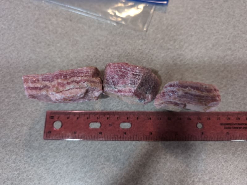

Post by rocknrob on Aug 15, 2025 14:24:19 GMT -5
I finally won some rhodochrosite off eBay. Now it just occurs to me I have no idea how to process it for cabs. It's super pretty stuff though, nice banding. Is there anything for me to watch out for? Does it need stabilizing? - Rob

Post by rockbrain on Aug 15, 2025 14:45:05 GMT -5
I've only done a small bit of rhodochrosite but I've never had to stabilize it. They do break when you drop them! I've had some small nuggets like that. I just slabbed them up the trim saw. You'll want to turn those pieces so you capture the bands on the face of the slab. Those should be pretty.

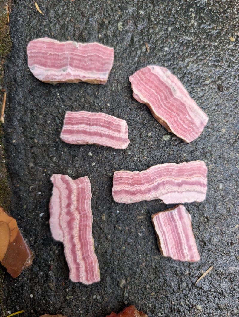

Post by rockjunquie on Aug 15, 2025 23:17:36 GMT -5
Now you're speaking my language! I love rhodo more than anyone, to be sure. It's my favorite stone to cab. It cabs VERY easily. Not chippy and not tooo soft. Yes, it is soft which makes it so surprising the glassy polish you can get.
I have started on the 80 grit to do the outline and then followed the usual route followed by 8, 14, 50 and sometimes 100 grit diamond. It never disappoints and is rarely difficult. I think once you start your first cab, you'll get a feel for it real quick. It's not difficult, at all.
You should get some nice bacon cabs from that rough.

Post by rocknrob on Aug 16, 2025 14:56:17 GMT -5
OMG These almost look tasty enough to eat! Cuts about as quickly as lapis. Too bad they don't have druzy. 😁 I'll post this and some other pics in the "what's in your saw" forum once I get my Internet back. I was just so excited about this stuff that I had to post it here. What nice bacon 🥓! - Rob
