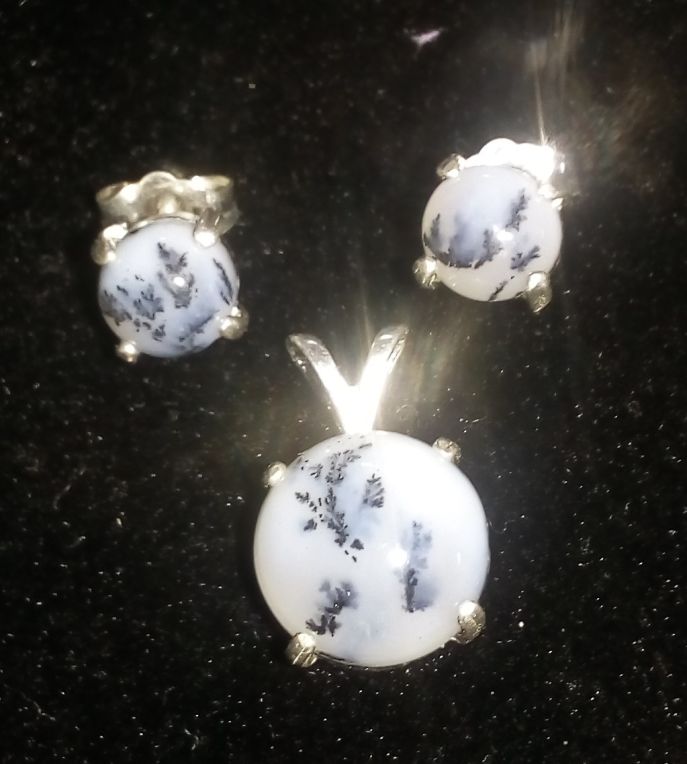

Post by rivarat on Jan 9, 2019 20:36:14 GMT -5
I prefer super glue on the head of a nail, sometimes epoxy. Superglue worked for these I did yesterday, small ones are 6mm
Post by rockjunquie on Jan 9, 2019 21:00:53 GMT -5
I prefer super glue on the head of a nail, sometimes epoxy. Superglue worked for these I did yesterday, small ones are 6mm Those are really nice! Is that Aussie dendritic opal?
rivarat
Member since June 2016
Posts: 140
Post by rivarat on Jan 9, 2019 22:35:17 GMT -5
I prefer super glue on the head of a nail, sometimes epoxy. Superglue worked for these I did yesterday, small ones are 6mm Those are really nice! Is that Aussie dendritic opal? Yep - Aussie dendritic opal Also doing a sets in blue lace agate and cathedral agate.
