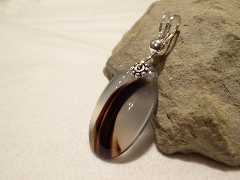

Post by Drummond Island Rocks on Feb 8, 2019 21:28:33 GMT -5
The grommets look good Jim. I have made a few drilled hole pendants using these off the shelf little embellishments. They are not attached to the stone the wire just holds them in place. Might look pretty good with your stuff and they work on surfaces that are not perfectly flat. I liked them because they are big enough to hide the blowout that can happen drilling agates. Chuck
Posts: 36,155
Post by jamesp on Feb 9, 2019 5:42:59 GMT -5
The grommets look good Jim. I have made a few drilled hole pendants using these off the shelf little embellishments. They are not attached to the stone the wire just holds them in place. Might look pretty good with your stuff and they work on surfaces that are not perfectly flat. I liked them because they are big enough to hide the blowout that can happen drilling agates. Chuck That is a beautiful piece Chuck. Very creative and unique metal smith work. Wider flanges would be useful to hide larger blow outs typical of glass. 2.7mm sterling silver grommets cost about $15/100 pieces from Megabeadstore, not bad. These have small flanges and it makes sense that they would work well on curved surfaces. A 2mm bit makes closer to a 2.7mm hole in glass using my particular Dremel press.
