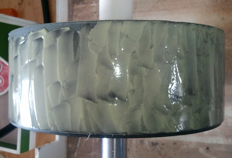

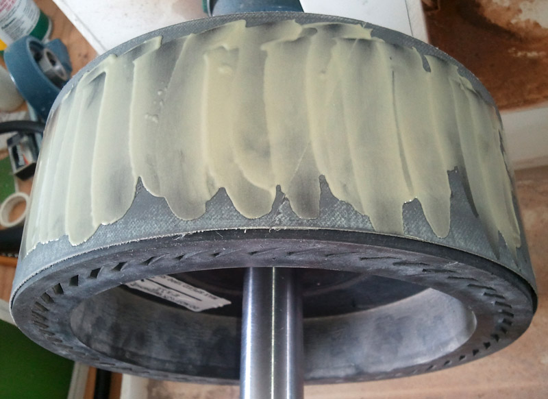

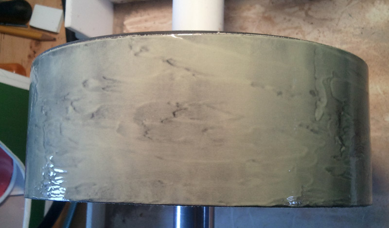

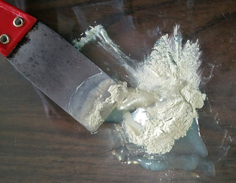

I wasn't happy with the linear polyurethane that Woody suggested. Read my previous comments about that. Harold suggested Epoxy 220. Last week I coated 2 Nova wheels & 1 8x3 belt using Epoxy 220 & 300 & 600 synthetic diamond powder that I bought on eBay. I'm very pleased with the results. It's only been a few days, but I don't see the glazing over that I saw with the linear polyurethane. I coated another 8x3 belt, but used epoxy from Ace Hardware. It seems just as good as the Epoxy 220, which I can't buy locally & have to pay to have shipped. Mixing epoxy & 600 grit diamond powder on glass. I used about a 3" long bead of each epoxy component.  Initial spreading  More spreading  Final spread. I never got it completely even, but it still works. This is a much thinner coating than I used with the linear polyurethane.  Please add your comments. It's great to hear everyone's success & failures stories. Lynn
