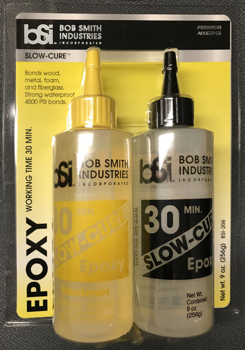

I've been re-coating diamond belts for about 6 years now. I do 300, 600, 1200, & 3,000 grit. It all goes on in one coat. I mix the epoxy with a putty knife on a sheet of glass, add the diamond powder, continue mixing & then spread it on the belt while its mounted on the drum. I use 30 min epoxy. I've been using Bob Smith Industries 30-Min Slow Cure epoxy. About $16 for a 9 oz mix. I made the switch from 15 to 10 carats long ago. From what I remember, 10 carats seems to cut better than 15. Diamond is pretty cheap, so do some experimenting to see what works best for you. I've been paying $28 for 100 carats of diamond powder on ebay. Lynn edit 11.09.17 I found the BSI 30 min 9oz. epoxy for $13.39 here: modelmerchants.com/shop/bob-smith-slow-cure-30-minute-epoxy/?attribute_pa_size=9-oz&gclid=Cj0KCQiAlpDQBRDmARIsAAW6-DNEzK5r0r-jDcP-nwiO88Br9mHyucYE1sJsmWWclPVEp7rS1A0zG5oaAkzfEALw_wcBEDIT 10/2021: The above link is dead, but I'm sure you can find this epoxy or similar other places.
