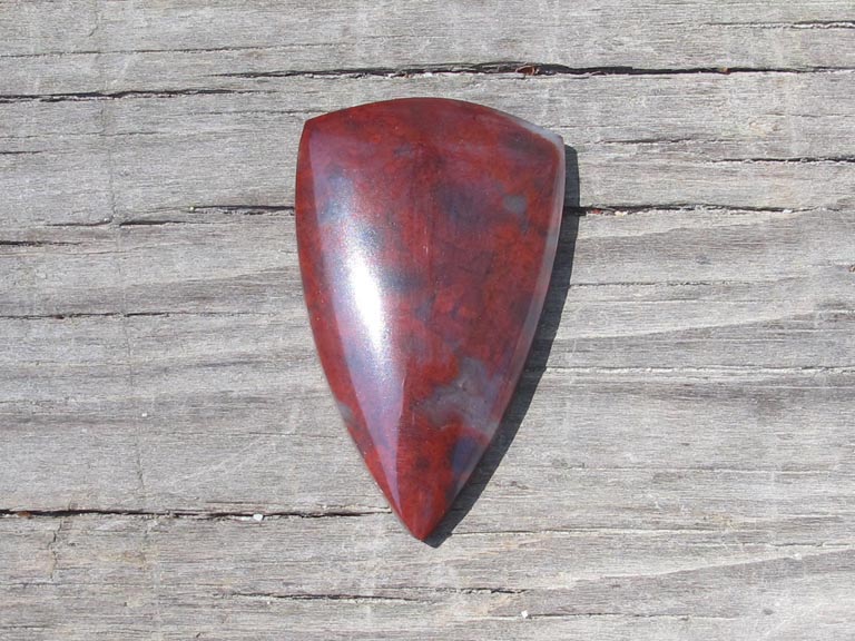

Anyways, I have always had an issue with polishing jaspers. I use a Hitchediamond Slant Lap and typically use 80, 220, 325, 600, 1200, 3000, 14k, 50k and 100k diamond paste on polishing pads in that order. I also have a cerium oxide charged lap that I've never used. Every jasper I've ever polished (unless I polished it with facets) has always come out a little cloudier than agates and others that I polish. I try to spend a lot of time on my 220 grit lap since that usually works for any trickier rocks I cab, but not for the jaspers. Why is this? I feel like I spend a good amount of time on each grit and its not like they come out scratched, they are smooth but cloudy. They don't have that high gloss finish. Any advice?

Some jaspers are just like that. Which ones are you having trouble with or is it all of them? If you can polish an agate, you can polish a jasper. Maybe you are comparing some that really shouldn't be compared?

Some jaspers are just like that. Which ones are you having trouble with or is it all of them? If you can polish an agate, you can polish a jasper. Maybe you are comparing some that really shouldn't be compared? This makes me think of the Mary Ellen jasper cab I did not too long ago. Turned out beautiful, no scratches, but was more of a satin shine than a mirror shine. Someone had told me that not all jaspers polish up so shiny, but that's just how the rock is. I wonder if that's whats going on here. zosrocks - can you share photos of what you've done?

I kind of have the same answer as I gave for tumbling jasper although I have had a lot more success polishing jasper on a cabber. Not sure how the slant lap will do with it. I have tried polishing really soft jasper on the cabber and it just won't polish well. But harder jasper does well on the cabber. If you are polishing red jasper, does it turn you liquid red when polishing? If so it might to too soft. My rule is if it is making a red mess, I return the rock to nature.

Unless I read you wrong, I have to disagree. I love red jasper and I have cabbed a bunch of it. It always turns me red, but it's worth it. Same with Tiger Iron. Lots of very nice rocks bleed like crazy. Probably a lot of variation. I haven't polished higher end purchased stuff . Just rocks I find around here. There IS a lot of variation- you're right. Thinking about it... I had some cave creek red jasper that polished like Mary Ellen. It's really red.

A material can have different grades and better material may polish better. Different material can require a different polish. Paul has a special technique for MHPJ that borders on alchemy. I normally polish everything with 100k diamond paste. When I wasn't getting satisfactory results I tried zam. I think the problem was that I needed to refresh my diamond paste.

Who's Paul? And how is zam used? With a burr or something? Sorry I know very little about alternative polishing options LOL. Paul is fencejumper. I apply zam to a separate pad, the same as diamond paste. zam comes as a stick and I hold it against the rotating pad to apply. Thank you! I will try that out.

I have cabbed every single one of those jaspers...and got nothing more than a matte finish on them. Not that that should make you feel better...but it should make you feel like you're not alone! LOL Thank you, that is good know that I'm not the only one struggling with them. One of my friends on tiktok suggested CO powder on a felt lap with a soft backing on high speed. I've got those coming in next week and am going to try that method and see if I can improve the shine. I do know Paul has talked about his method on Noreena involves going dry on the 1200 to get the piece super heated. I have diamond wheels...so I'm not going to risk them by not using water. I tried it a LONG time ago with my flat lap and melted the disk! Once bitten, twice shy! LOL
