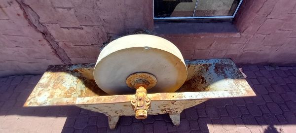

Post by mohs on Jun 22, 2022 19:16:41 GMT -5
certainly were much more enlighten grinders from the past geez those poor guys working the coal mines and elsewhere throughout history this is 100 year old grind that was in Phoenix blacksmith shop can only imagine ...
